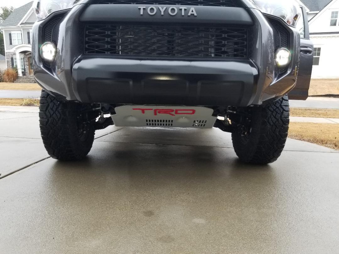

Swapped it out today, went pretty easily. Used the supplied bolts and all fit well. Ordered a new plastic lower skid valence (the part that fits between the bumper and the OEM skid), so I can trim it to fill the space. I've seen others do it so hopefully can make it look clean. Tried to add some front access points today from Apex Overland but one of the bolts didnt line up, will play with those another day. They are red as well, so should look good with with the red on the skid.
