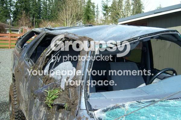

I crashed my first runner doing 45, 1 side roll and 1 endo and still couldn't get either of the airbags to deploy.
rolled.jpg~original
