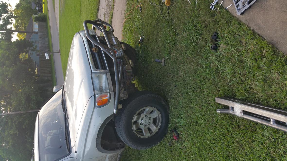

Finnnnnally got my front bumper from Addicted. Bolted right up after a little grinding.

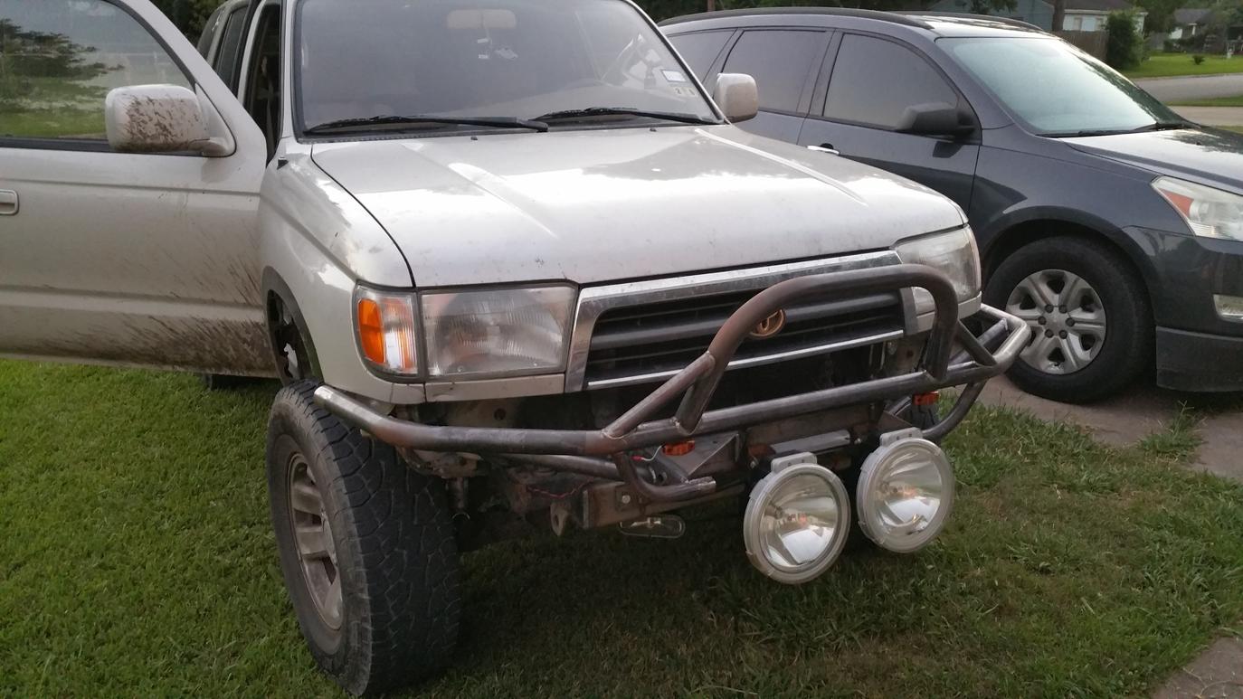

Got some pro comp lights for the front. Not sure if I like them. uploadfromtaptalk1433989460564.jpg
Got some pro comp lights for the front. Not sure if I like them. View attachment 161274

I just ordered my own tube bumper from Addicted Offroad and I'm wondering what tools you needed to install the bumper and what the process is to put the bumper on.
You have plenty of time to get everything together..... took 7 weeks. And they said they have a new welder.
But worth it I think. Just have to remove the old bumper and the front mounts on the frame. Use a grinder to grind down the edges. It comes with all the hardware. 17mm wrench you'll need. Pretty simple. It's raw. So be prepared to paint it.

What do you plan to do with the unsightly front end after your install? Im not too fond that you can see everything...THeres got to be something i can do. The OEM Bumper hid a lot. New bumper, not so much.
Any ideas?
Any ideas?
I'm planning on leaving it as is. Maybe you could put some kind of rubber sheet like a mud flap in the front or add sheet metal to the bumper yourself
