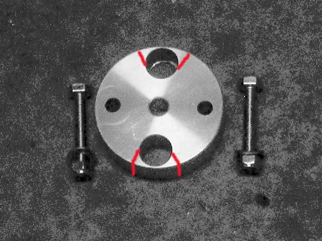

The other option is to cut the steering extension, which will not affect the integrity of it's purpose, but make the install much easier without having to spin the wheel. See pic below (Photo credit to [MENTION=95421]Troymclure[/MENTION]):
But again, if you are only doing a 1" body lift, don't even hassle with the steering extension, as it is NOT required.
