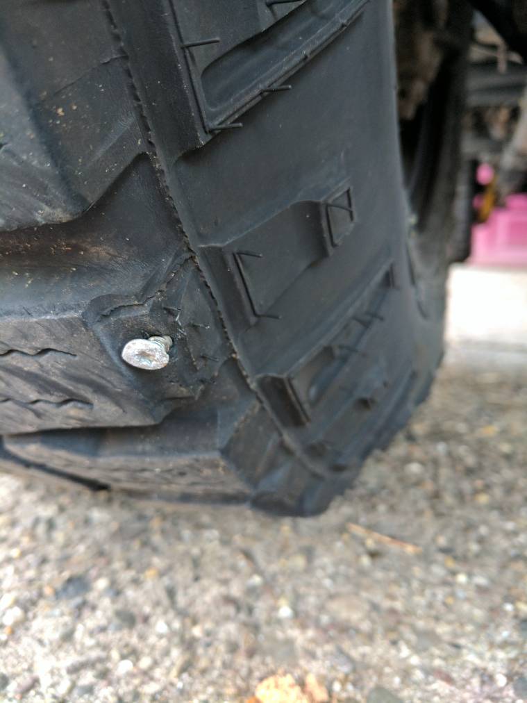

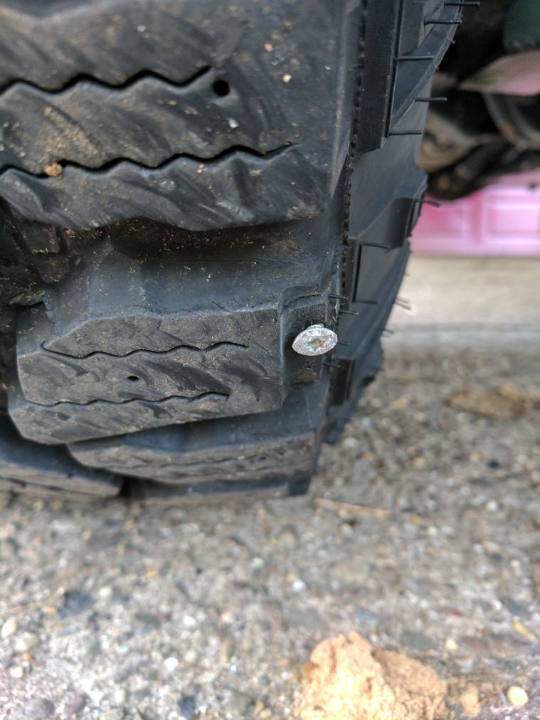

Hey guys. Just found a screw in the tread really close to the sidewall on one of my tires today.
I'm reasonably certain a plug will be just fine, but will it still be safe to air down to 15 PSI when off-roading or will the plug be compromised?
I've never dealt with tire repair on an off-road vehicle before. Obviously I'll be taking it to a shop. Just looking for some thoughts on the viability of safety vs replacing the tire. IMG_20170101_155102.jpgIMG_20170101_155105.jpg

IMHO - I think this is a fixable item. You are close to the sidewall but still away from the side wall. It is possible a tire shop may refuse to fix it for liability reasons. I would just plug it and drive it.
not repairable :sobbing:

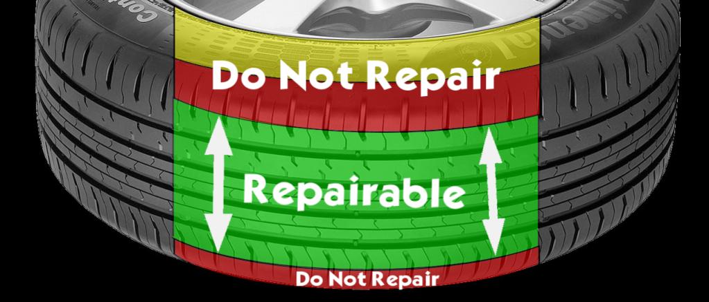

Actually this is something a tire shop would not repair but you could do it yourself

I wouldn't repair it - not worth the risk. We had a similar issue on our 4Runner. I had the spare put on in place of the bad tire and bought a new spare with a more aggressive tread. 4 more nails and I'm good to go!
Is it actually leaking? If it is, I would have no reservations about plugging and forgetting about it.
Too close to the side wall. Not worth the risk IMHO. There is a reason shops do not repair tires with punctures in that area. Did you happen to get replacement certificates or anything like that?
The shoulder area is where the most heat generation occurs in a tire. If that area is damaged, you might not get the heat dissipation that you need to maintain the integrity of the tire. It could result in the tread separating from the rest of the tire.
Recommendation: replace the tire.

[MENTION=126590]bloodninja[/MENTION],
That's definitely considered sidewall.
I had a stone penetrate the tire closer to the center than of your nail location and it was considered sidewall and replaced!
Thanks for the quick responses, guys! Much appreciated!!!
I'll have it replaced to be safe. Nothing in the world is worth saving money if it means putting myself, my family, and others at risk :thumb:

One other thought. That screw is in a deep lug. You might try removing the screw itself to see how long it actually is. If it's only a 1/2" long this could be much ado over nothing.
I noticed it was in the lug as well, but the screw looks like a star driven so it's probably a deck screw. Based on that I was thinking it's going to be longer, and since on the edge, probably just best to go to the tire shop.

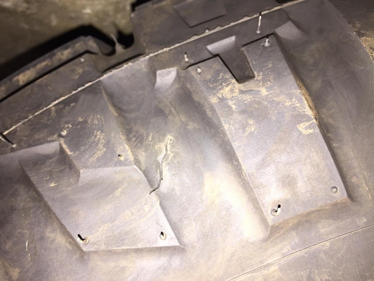

Came across this older thread and saw your full disclosure. Would mind commenting on this sidewall cut?
Pretty shallow, no threads showing. Appears to be superficial cut, but I speak from no experience.
Thank you

I wouldn't drive my wife, kids or dog around in a vehicle that I knew had a defect like that in a tire.
Spend the $$$ and have piece of mind.
Thank you
Depends on how deep. Could be a short screw, I'd probably replace it if the other tires don't have many miles. Some shops won't repair any sidewall.
Thank you
While it doesn't look bad, I can't really determine where on the sidewall the cut is...
You could up your air pressure check frequency and find out if you're losing air. Everything else is all about your piece of mind.
