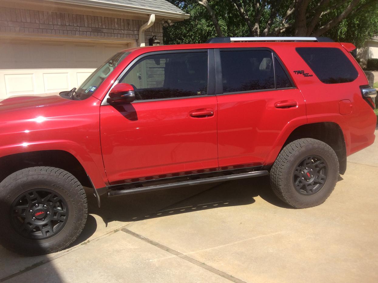

Purchasing my Lift Kit!
WhoDoiFollow
Dobinsons.
But im not sure which kit is the best bang for its buck.
- If i go with toytec will i need to upgrade Front coils? Rear coils? Upper control arms? Rear shocks?
-If i go with Icon will it have everything i need?

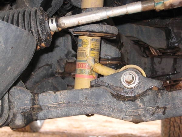

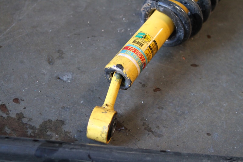

Spacer lifts if not done correctly will damage your truck.

Even on the street. People don’t realize when using a top hat spacer lift more needs to be done. You NEED to also get a bump stop spacer so you don’t bottom the shock out.
