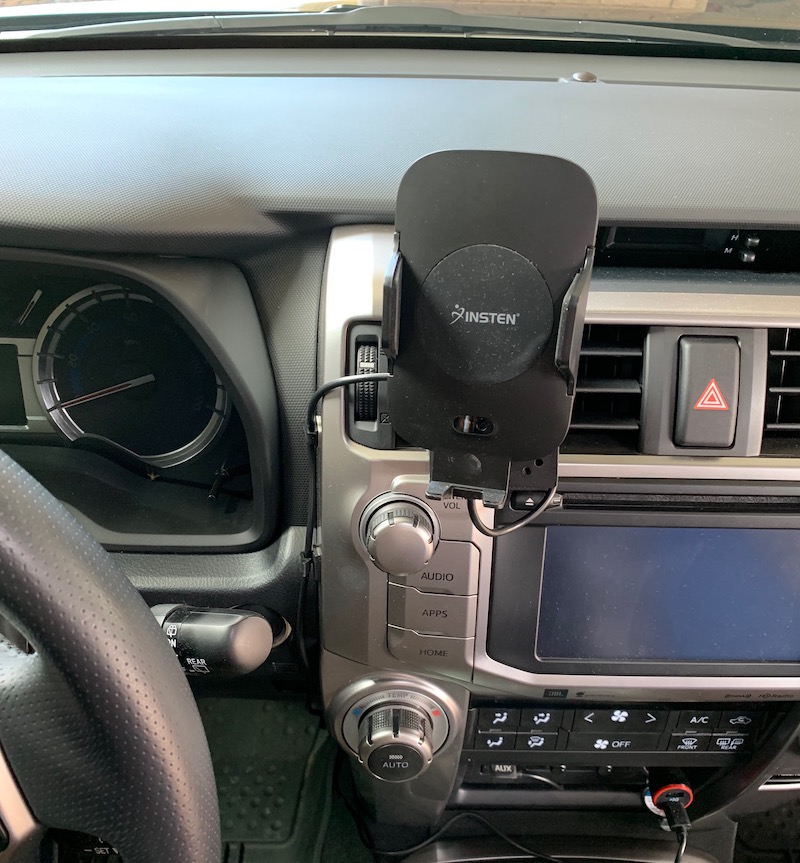

I went searching for a charging mount for my iPhone XS Max. My favorite vendor of these types of mounts is Proclip, but they don’t have anything yet. I could not find any other options that I liked, but I came up with a solution I am happy with.

This mount came with a vent clip style mount, which I did not use. I combined the following;
- my existing Proclip base mount
- an extension plate (Proclip) which already had
- an angle block (also from Proclip) just to angle the phone towards me a little bit
- and a small piece of sheet metal
I drilled holes in the right places on the sheet metal to mount to my existing base, and then drilled a 7/8 inch hole to accommodate the Insten mount. The 7/8 hole needs just a small amount of filing.
On the back of the Insten mount there is a round threaded post, and a plastic nut is on the vent mount. That is how I attached the mount to the sheet metal. See pics for more detail. The nut is held to the vent clip that you need to cut off. Cut where the red arrows are in the last pic. Keep the nut, throw the vent mount away.

I'm happy with the result, and love the cool factor. The holder grips the phone firmly, but if you shut off the car, you can still remove the phone from the mount without power.
Final installation views;

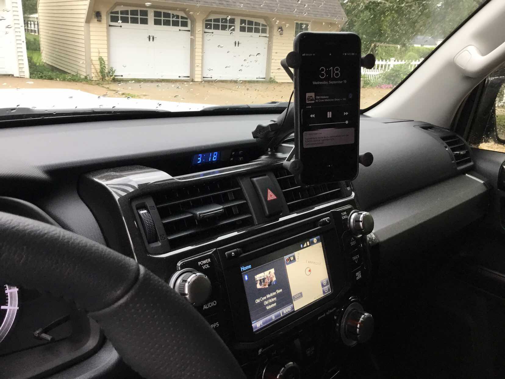

I need to find a charging pad to use on my RAM x grip, I wonder if I can use this and take it apart and place it over the center of the x grip
I think you'd be better served by a simpler charing pad for that. This one might not be easy to pull apart and keep the pad intact...

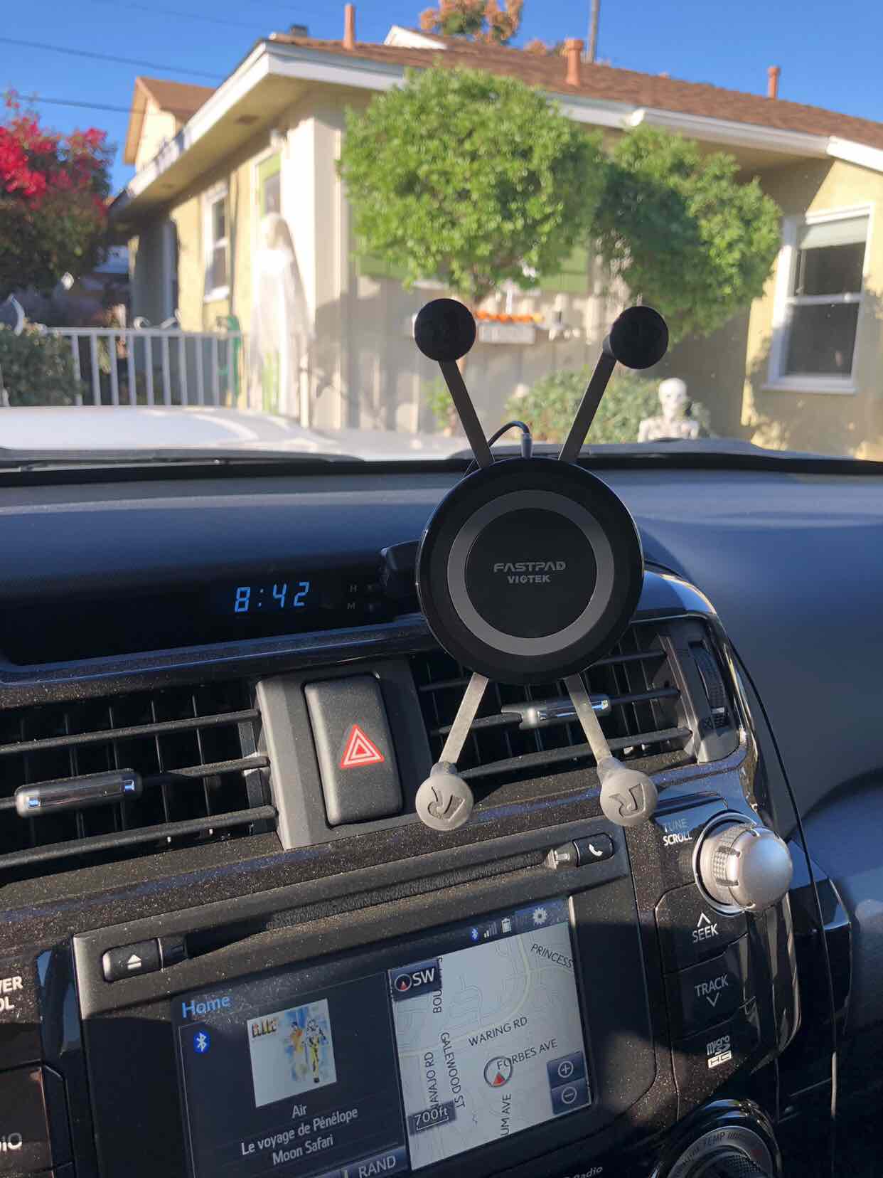

I got this one because it's the thinnest I could find and used double sided tape to add it. Nice and clean.
FASTPAD Ultra-Slim Wireless... https://www.amazon.com/dp/B078MGY2S1?ref=yo_pop_ma_swf.

You know I had to position my charge pad way up so that it would be in the area of the coils. If mine were placed that low it wouldn't charge due to the positioning of the pad
