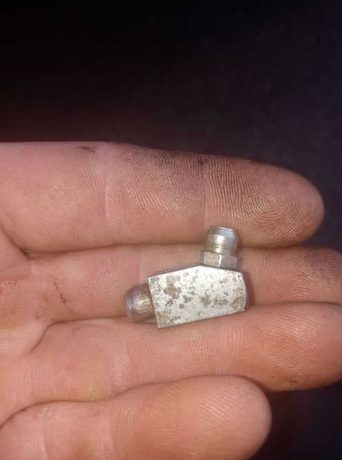

Went to grease my drive shaft today and when I got to the 8th and final zerk fitting, the one for the rear spider bearing, I noticed it move a bit when I was putting the grease gun on. I wiggled it a bit more with my finger and the fitting came out with another small piece that the fitting screws into. I put it back in but it doesnt seem to want to stay there. Can anyone tell me what this piece is and how it is supposed to fit into the bearing? Thanks in advance.

Looks like it just a press in zerk
I’m more of a screw in tan myself
So this doesn’t happen
I did buy a press in zerk assortment from tractor supply not that long ago
Or I’m sure your local Napa could help
Well the zerk is a screw in type. This is the piece that came out along with the zerk screwed into it. Maybe this piece is a "press in" type? No clue.
