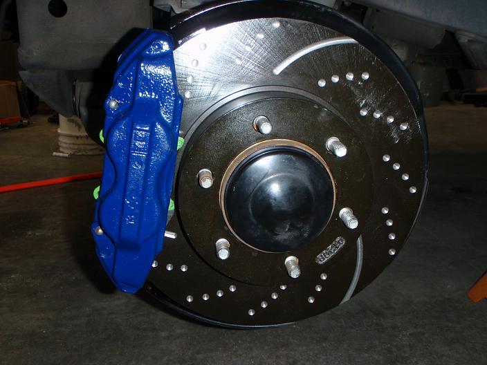

what exactly is the hub bore? I don't mean to sound like a noob haha but I am new to all this. And how would I figure that out?
Usually it's listed in the wheel's specs. See the center hole on every wheel? It's designed to fit over your trucks' hubs and since every manufacturer uses different sized hubs, it's important to make sure you get the right ones.
Aren't most aftermarket wheels lug centric though? From what I have read it seems pretty hard to find a hub bore of 106mm. I am stuck on what to do.
Right, but if the wheel physically doesn't fit over the hub, then you have a problem.
In the above picture, you'll notice the center black cap. That's your hub shield, cap, protector ... whatever you want to call it. It has a diameter of 106mm, so you'll need to at least clear that, and then rely on your tapered lugs to center the wheel.
Make sense?
Make sense?
