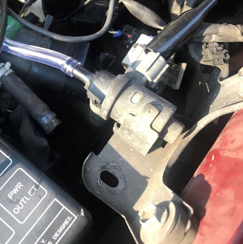

1. is the vent solenoid normal open when the car is off and no power?
2. when i supply power to the vent solenoid and apply vacuum pressure, it build ups pressure and slowly leaks down (bad solenoid)? I know in the picture i have the valcume hose hooked up backwards, i tested it the other way around (right way).

No evap experts here? Should that solenoid hold pressure?
I am no expert but what little I know of evap systems. The vent solonoid is always open and the purge solonoid is closed . The pcm opens and closes the vent and purge solonoids there is a procedure for testing the solonoid in the fsm. hope it helps

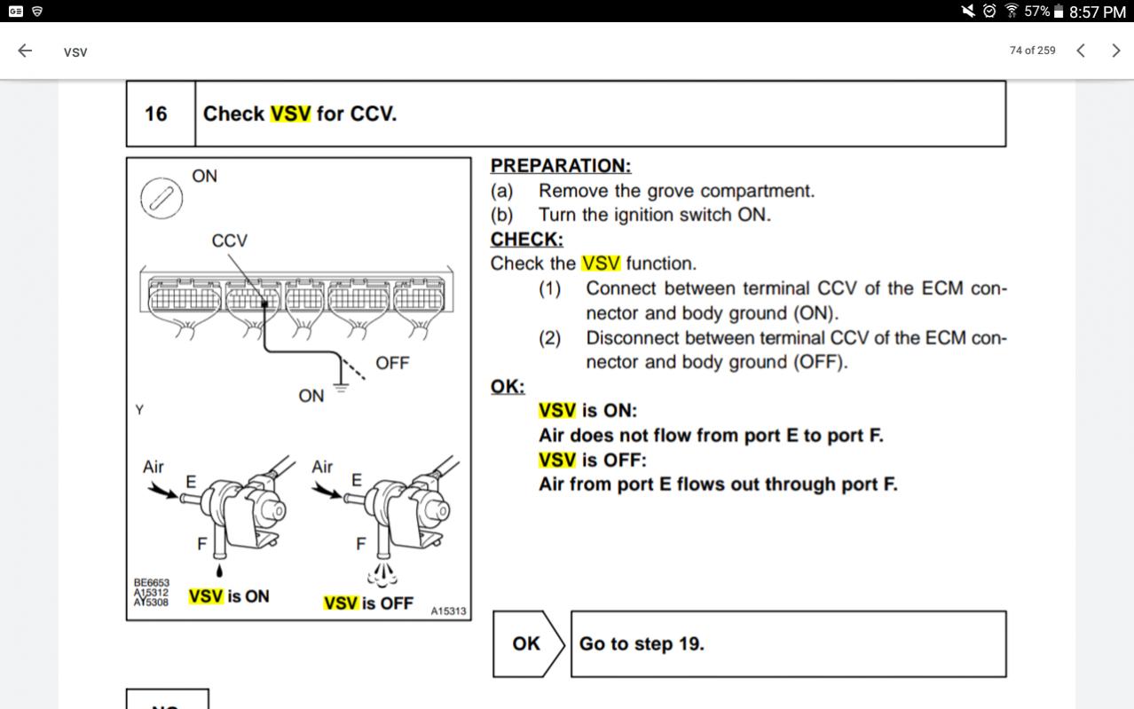

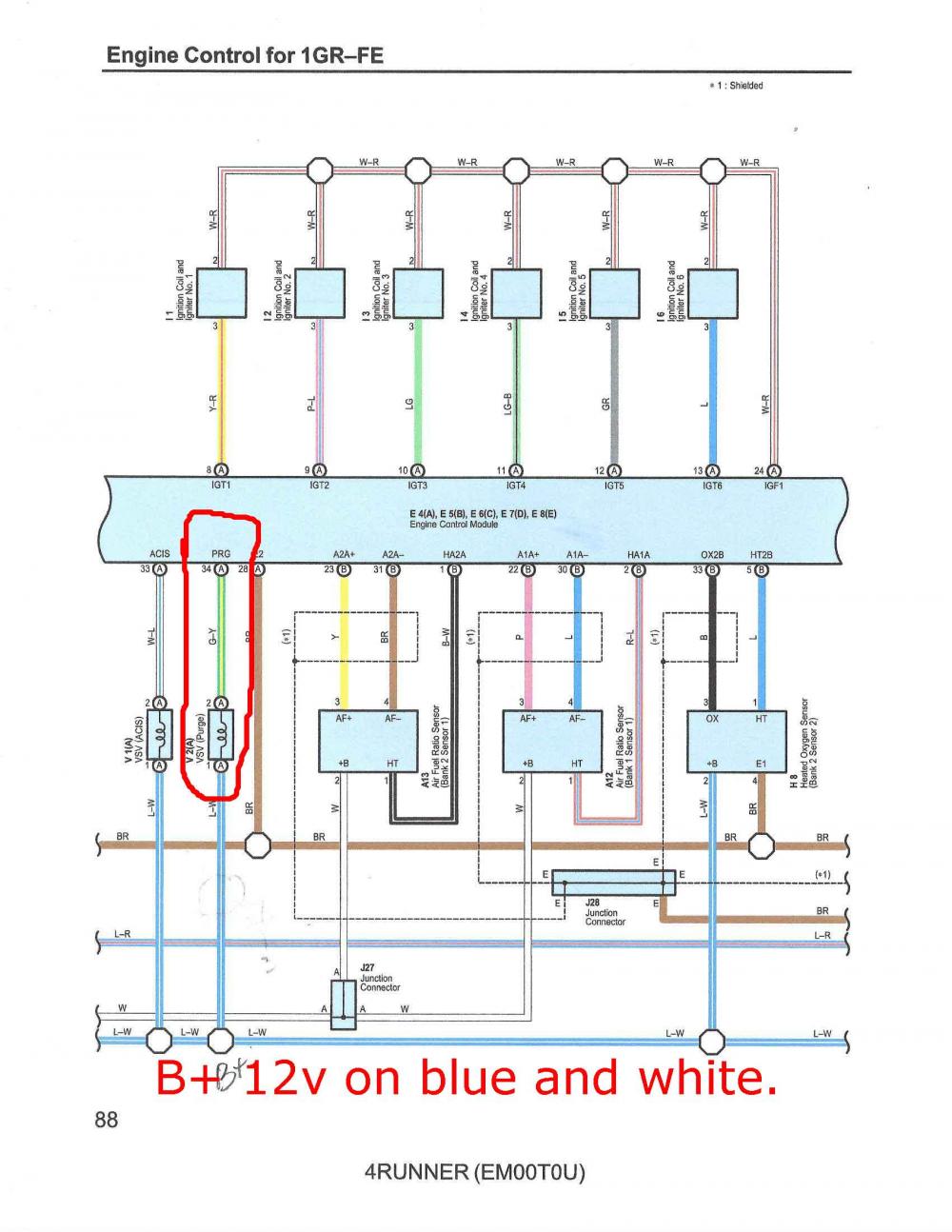

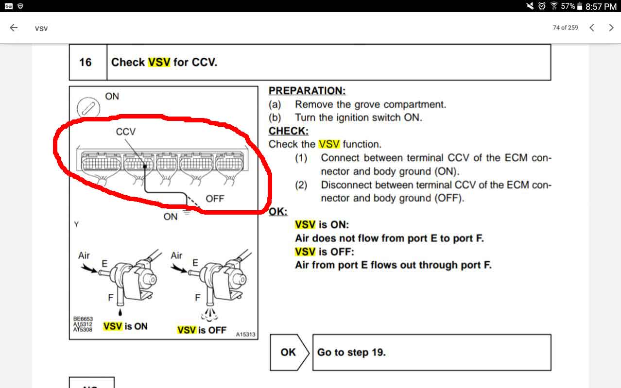

I couldn't get to the ECM easily so the blue and white wire at the plug is the B+. I hooked a jumper from the plug to purge valve terminal (B+). I jumped the ground terminal at the purge valve to the car's body. The purge valve activated. The yellow and green go to the ECM and internaly it connects to ground. Do I have a defective ECM?
