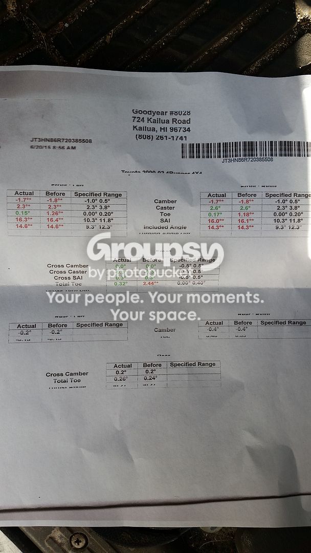

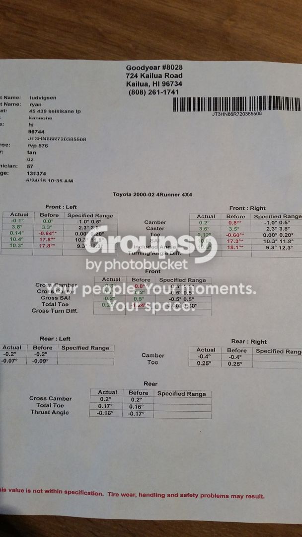

Did you get a before and after printout? If not most modern machines save them automatically. Go request it and upload a picture of it.

Thanks for the responses. Im going to bring the truck back in the morning and see if one of the more experienced guys can get it. I figured with the new upper control arms it should be easy to align properly. Also I do have the print out at home ill snap a picture and upload it. While driving to lunch you have to keep the wheel slightly right which is annoying.

heres the print out
so camber is still out on individual left. but the over all in the middle is good.
--Lud
seems like they didnt do shit except adjust the toe. I would take it back and tell them specifically that all of the numbers should be within spec. there is no excuse for that shitty camber. basically the cross toe is the only cross number that matters. the camber should be basically 0 as should the toe. the caster is less important and should be adjusted last. from what absalom told me, the tech should most the front cam all the way in and the rear cam all the way out, then adjust the camber with the upper control arm settings, then tighten down the upper control arm, and go back and mess with the adjsutment on the steering rack and the lower cams. if theh cant do this ask for a refund. my lca bushings had completely rotted out and they were still able to get my truck in relatively good alignment, with what you have there is no excuse.

So brought the truck back in for alignment and talked with a more experienced mechanics about hot to adjust caster and camber. We determined that i need to add 1 to the caster. He said he would have to charge me labor to make the adjust and so not willing to do that i brought it home jacked it up and changed the ball joints to the c setting on both sides and i pulled the bolt all the way out to have chamber out the most possible. it took about 10 min to do. Went back up and im guessing he supervised the guy doing the alignment called back in 2 hours and everything is back to factory specs. so thats good. now im going to see if the zero calibration fixed the traction control thing. if not i guess it will be something i have to live with
