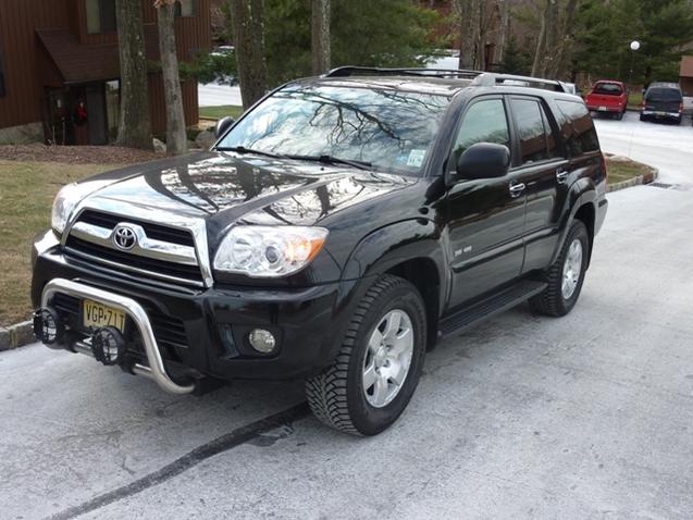

J j-dub Member Dec 9, 2013 #5 I thought I had a few but can't seem to find them. It looks similar to this: If you have any specific concerns or angles you want to see let me know.

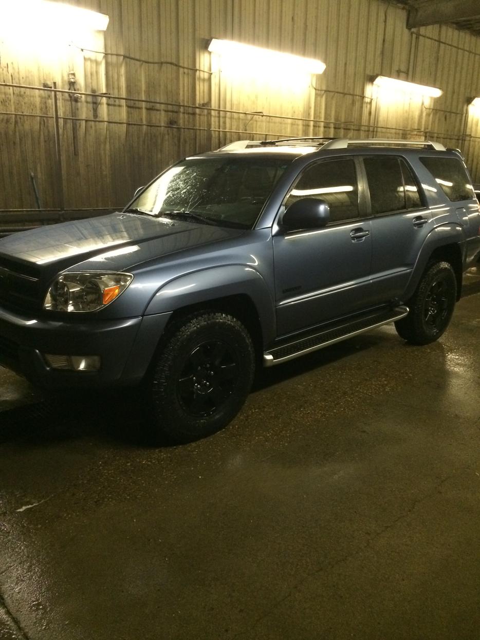

Mudyrunner Member Dec 10, 2013 #6 YES they will fit . Thats the exact set up i have. 265/70/17 on stock with zero rubbing issues. Attachments photo 1.jpg 130.6 KB · Views: 1,119
