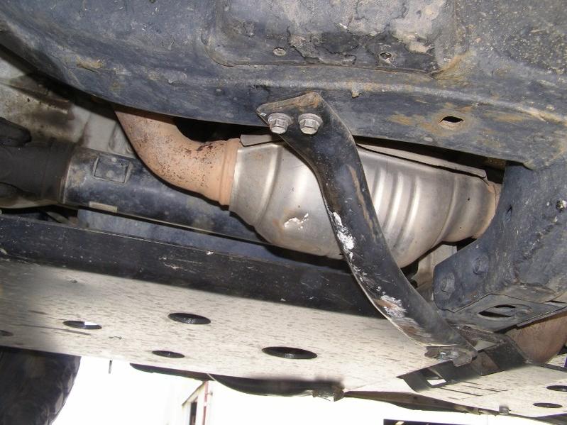

I still put mine on/off as I need due to off roading, they save my CATS from being smashed if I do difficult trails as I have sum dents in them already from not having them on. If you do want to put them on, you will have to smash some of the round part of the tube on them as it will run across your plates and WON'T be able to mount on. I think you might need longer bolts also.
