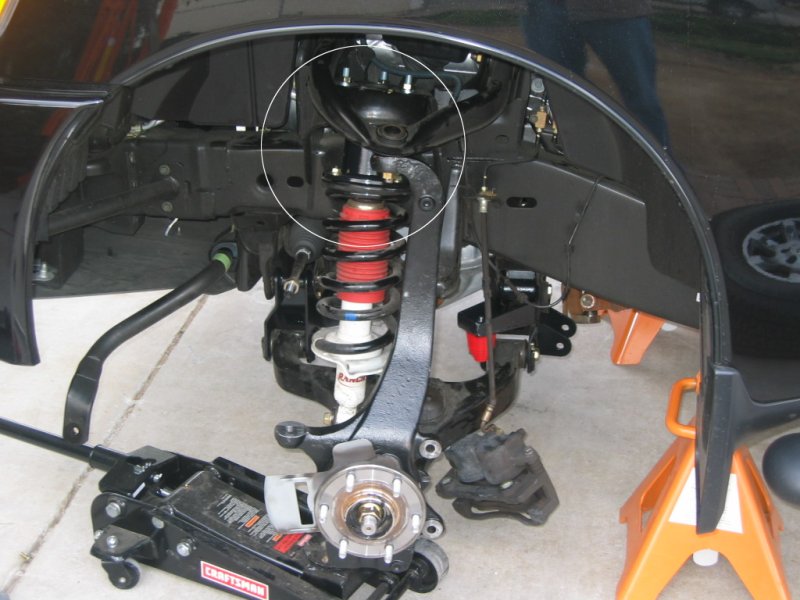

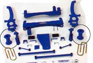

I know we've been talking about rear suspensions but here's what I've been thinking would be nice in a spacer lift kit (particularly with XREAS if you want to keep the shocks).
These are some pics of Nissan Titan kits and front suspension. The circled parts are spacers for the whole coilover assembly that move the whole thing and don't decrease the droop travel. The rears seem to come with new shocks (presumably longer) but I'm thinking a simple spacer to move the shock mount down, for the rear shocks, would be good.
In another thread someone mentioned that adding such a spacer would introduce bending loads on the shock shaft, but I wonder if this could be avoided somehow.

M3_962 said:
... but I'm thinking a simple spacer to move the shock mount down, for the rear shocks, would be good...
That's what I'm working on right now. Tried couple of them, didn't work so far, but I'm still in a mood to find one.
