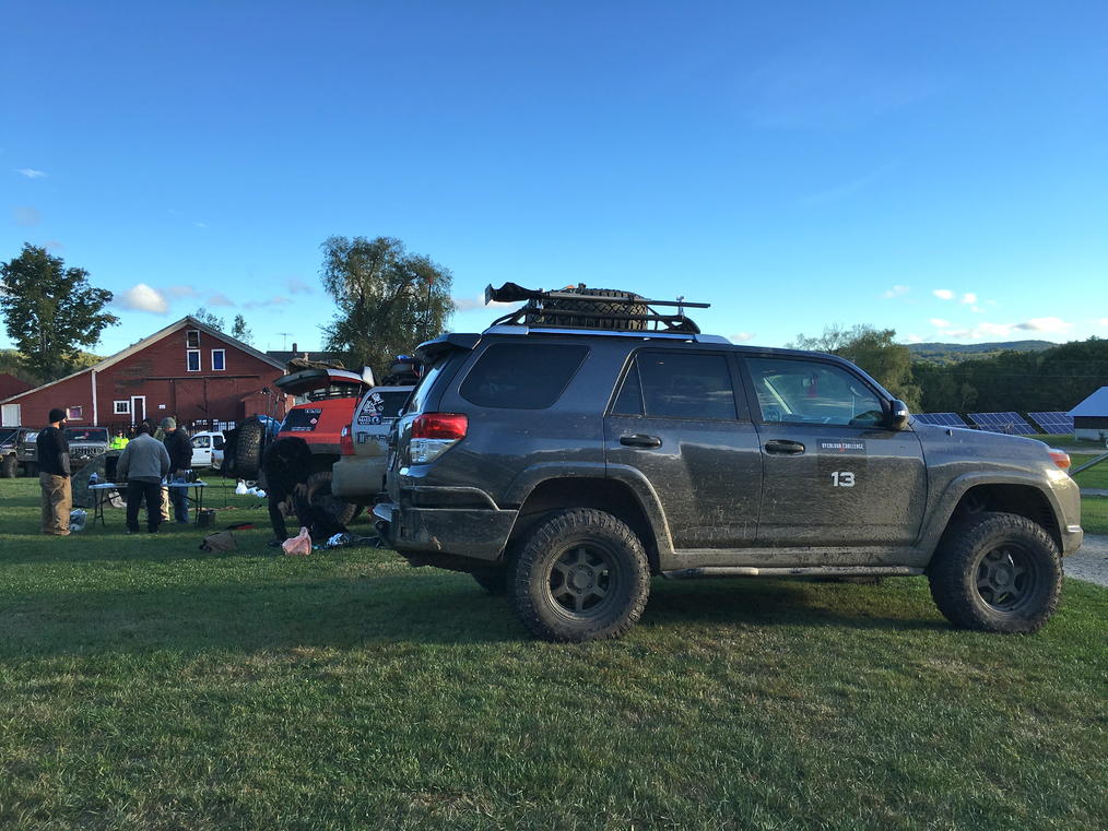

This is the same basket with extension on my T4R. I bought it used and it was Subaru branded. I replaced the fairing, but still reversed it, as you can see.
