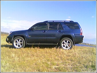

No you won't have a problem with rubbing. I have falkens 295's

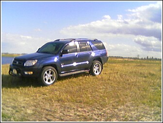

Ride quality did decrease slightly. And you'll need road force balancing, but it looks bad a$$.

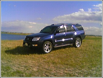

the 9.5 depth gives it a much wider stance that completely fills the whell well height and width wise.

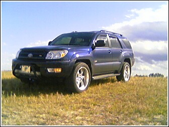

As for the tire pressure monitoring system, the sensors will not fit, because of the metal exterior washers. The air pressure will leak.
Tundra's have the new sensors, with rubber seals that fit these rims.
