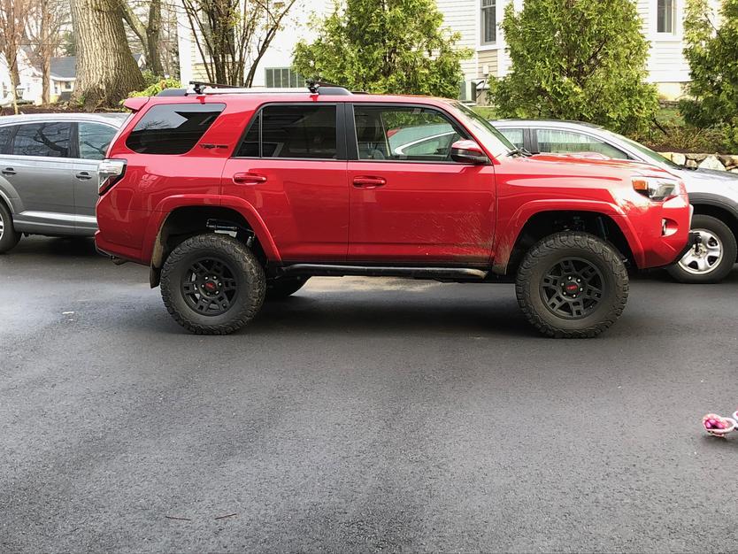

This is with a ton of preload dialed in. THe height has settled some since this pic, but its still sloshy as heck.

How much preload are you at currently?
I just adjusted my preload last night to about 12 threads (just under 1.25") showing. I have 650 lb springs on my King coilovers and am actually a bit high in front now compared to my rear with 2" (2.5" actual) Icon springs. Waiting to see if it'll settle, and I have a lo-pro bumper on the way which should help level it out. But anyway, I don't have any ride quality issues at all from such preload, and I attribute it to those 650 lb springs.
I don't think the method in the video is possible since the top hat as you said is different. Also, I had a hard time using a jack to compress the coilover using the LCA with the 650 lb springs and the preload. It wanted to lift the entire truck off my jack stands instead, so you might have some issue there even if you could disassemble like they did in the video.
