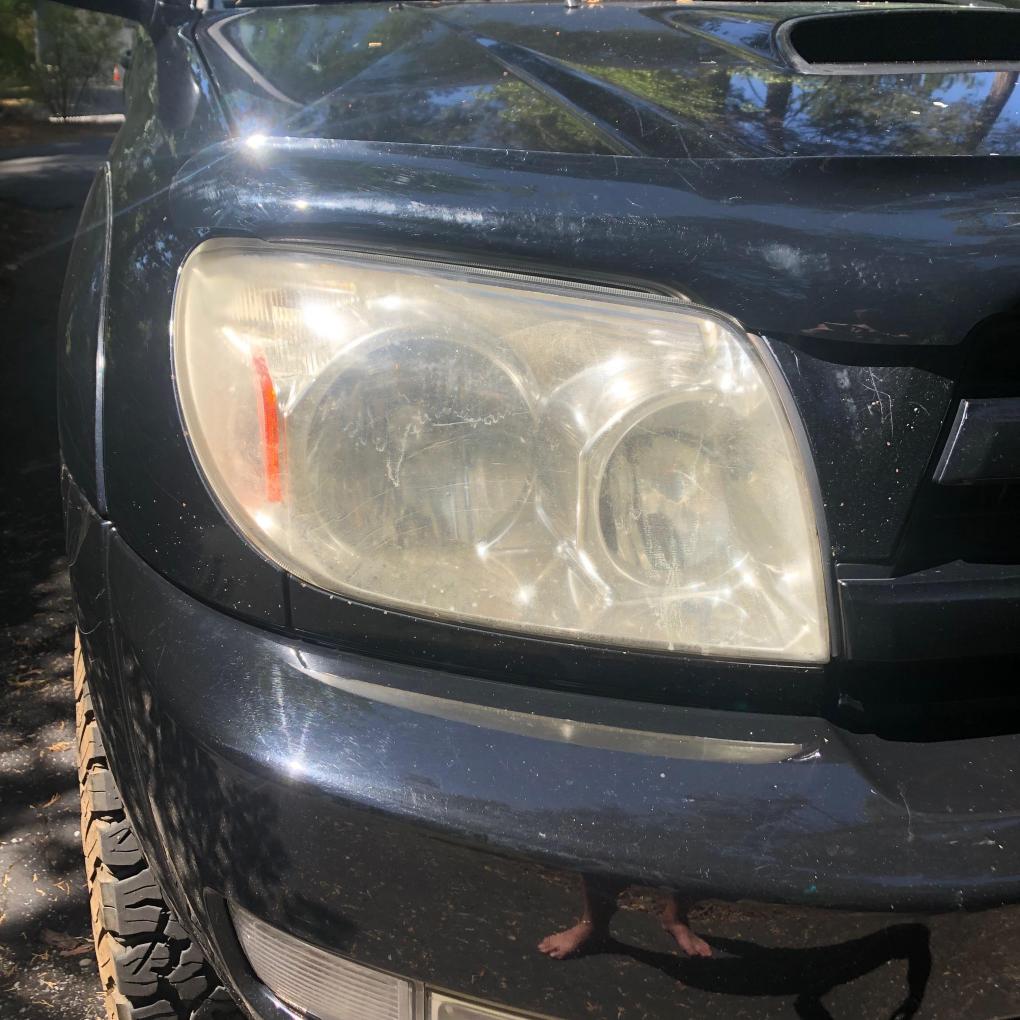

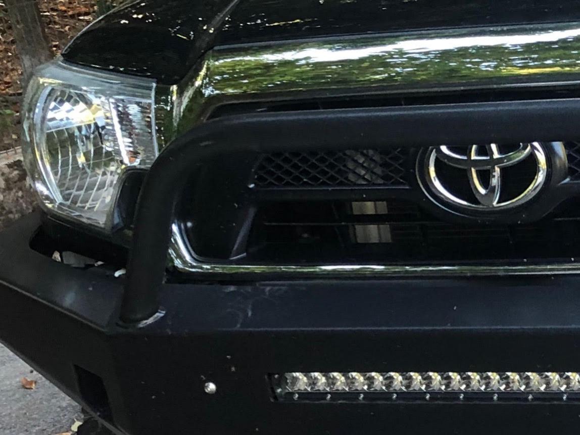

So...I need to replace my headlights in general. How do I change picture #1 into picture #2?

But if you're looking to clear your headlights there are numerous kits out there or DIY remedies (3M makes a great kit. The drill one will help get through better with how much you've got)
Otherwise buy new replacement headlight housings. Lots of information on the forum about both options (or all 3 if you really want to have those headlights!)

To get the headlights clear again a $30 kit from your local auto parts store (assuming you have a drill) and polish the hell out of them, or buy a new set: Security Check

You'll need to wet sand, cut, polish then add the secret ingredient, 2k catalyzed clear coat.
any "kit" u buy at autopart store will only be a temp fix for a few months. all the cutting and polishing is abrasive and removes the protective coating that makes headlights clear. that coating is already past its life so you'll have to add the 2 part clear coat to bring it back to new.
they make 2k primer in aerosol cans. look up Spraymax 2k, the original aerosol 2k clear.
too much work? buying aftermarket depo headlights will also be a temp fix. their cheap thin plastics also fade after a while and their optics are hit or miss but mostly miss. OEM is the way to go

I'd only use original Toyota headlights. Every 'oem' cheapie I've tried was garbage.
I've used the kits, to varying result.
That said, I had a professional headlight guy do mine a year ago. They came out fantastic from heavily yellowed to crystal clear. Much less expensive than replacing them.
TYC replacement projectors from rockauto ;) had them on for months
in downpours and mud bogging - no issues with leakage, all body lines are perfect. output is great, comes with all sylvania bulbs
I too have the TYC headlights...I upgraded mine to the 2006-2009 versions with the projectors and they've been amazing for the last 5 years of use and wear...I also threw in some DDM HIDs into the projectors and have yet to get flashed or observed that they aren't intended to be this awesome...Best money spent on lighting for my rig!

For my 2004 Rockauto shows 2 different TYC headlight replacements, one is NSF certified and the other is CAPA certified, which ones did ya'll get?
I went with the NSF...nothing but a good product thus far...I didn't confirm anything on the CAPA certified version...my NSF meets and exceeds my expectations though...
