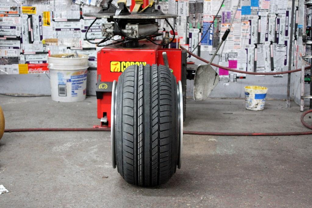

I might be wrong but a 285 on a 10" wide rim will look like this.
I know it's not a 20" rim, but I'm running a 285 on a 16x7 rim and they look good, I'm betting a 8" max would be ok.
recommended width is 7.5-9.5"
