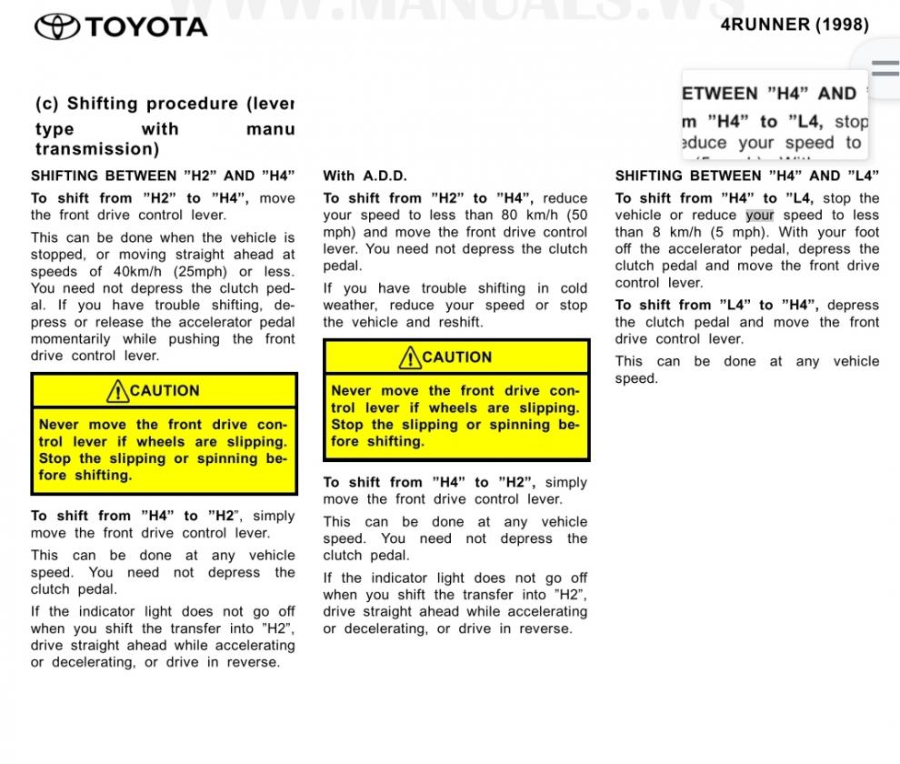

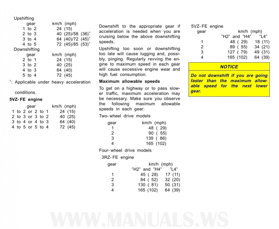

regardless the manual im shifting between H2 and H4 as slow as i can do, truck is old im not risking shifting at 50mph.
for L4 complete stop when shifting in and out of it.
