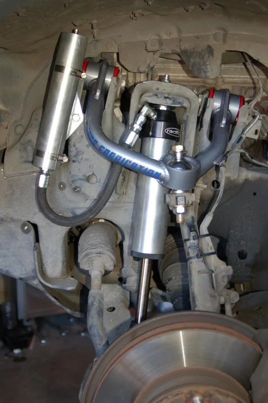

So I've been running Fox 2.5 Factory coilovers for about 3 years. They're swapped over from an FJ Cruiser/120 version. The problem I'm running into is the remote reservoir placement doesn't work on the passenger side. I chopped up the FJ cruiser mount and can make it fit just about anywhere because I have KDSS - so there's no sway bar to deal with where it's normally an issue.
My problem is that the reservoir hose is too short to orient the reservoir in a good place where it doesn't rub on the inside of the tire and full steering lock. They're mounted basically like this picture (not mine), but they rub, even with my street tires.
IMG_5743.jpg~original
This is how I had them mounted for a few years, but the hose is just too short to really work and the UCA ended up causing enough movement to be a problem. This location works a lot better for rub, but I need more hose. Or I would maybe just mount them in the engine bay along the firewall or something if I added long hoses.
