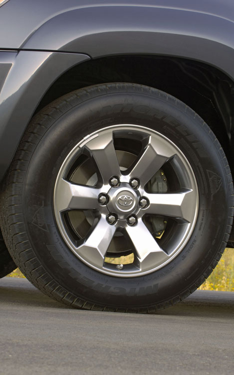

I just did some search on the forum and find out those 18' 4th gen limited rims. they said the rims are 18*7.5 and will fit the 5th gen
