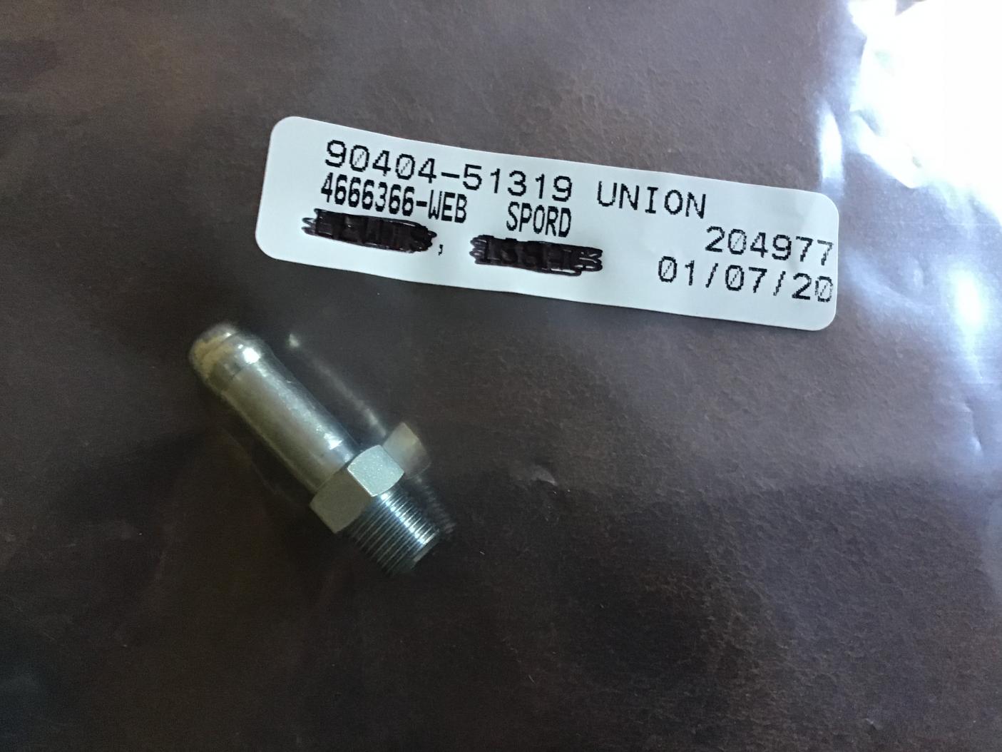

Will this part number work for the E-Locker? See pic! I got one for the rear diff but would like to do both at the same time.
