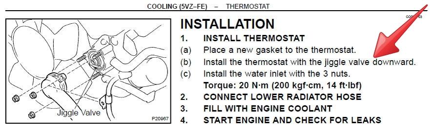

Coolant at normal temp(half way). (I need to fix my android tablet in order to get exact temps). The person before also put the jiggle valve at 6 o'clock instead of 12... So their job wasn't the greatest.

Sounds as if you did a great job and learned a lot. However, the jiggle valve is supposed to be at 6'oclock.

Haynes manual states that it's suppose to be within 15 degrees of the 12 o'clock position. This should be common knowledge since air rises to the top, not the bottom. If it's at 6 then it's done wrong.

The below is from the TOYOTA FACTORY SERVICE MANUAL. Haynes is only good for underwear. On here, experience has shown it works better ON THIS ENGINE.

Well that's extremely weird... It really doesn't make sense too when you think of physics and how air rises. I wonder why they have it as such.
It is one of those things where my limited knowledge of automotive physics doesn't allow me to explain why; I am just glad Durk chimed in with his PDF of the FSM showing that I wasn't crazy. Fellow members in the past show up to a 15 degree rise in coolant temps with the jiggle valve in the 12 oclock position.
