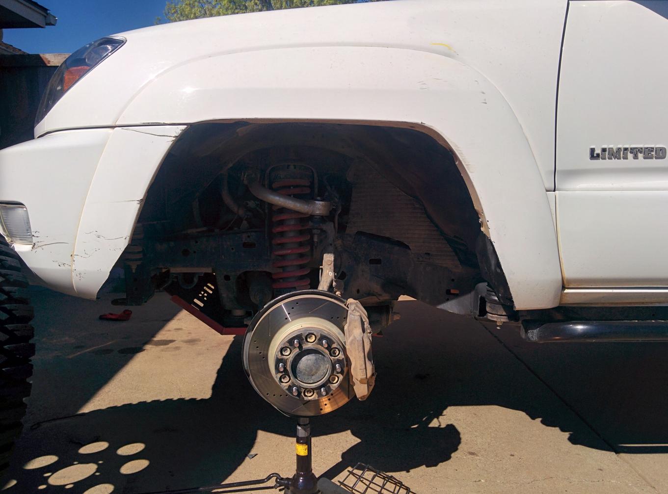

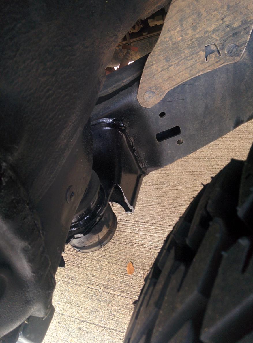

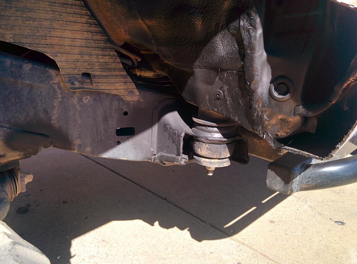

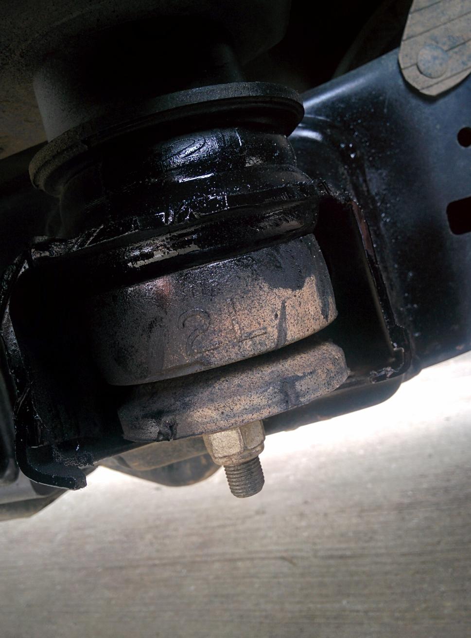

Hey, I'm about to do a 1" BL also in prep to run 35's can you post up pics of the amount of cutting that you had to do to make them fit? Thanks
I'll see about getting some more later this week

Do you not have to weld a flat piece in place of the curved piece you cut off? All the pics I've seen the guys weld it back together. I noticed you just cut and painted the edges. Thanks
Nah. You aren't cutting into the actual structural part. Some worry and weld something on. I've had mine cut for well over a year without a single issue.
short answer no.
the reason the body mount was designed the way it is is for another factor of safety for the passenger compartment. if you look at the rest of your mounts or any other mounts on a vehicle they'll most likely be similar to an L bracket with either a small gusset or a rolled edge. the reason some people weld it back over in some shape or form is either A) they think they need to since they believe it compromises the structure (which it doesn't). and B) so that in case the tire ever rubs it again it wont be cut up, but i just ground the edges that could be rubbed to a round smooth surface to get the same effect.
short answer no.
Perfect, thanks to both of you guys
