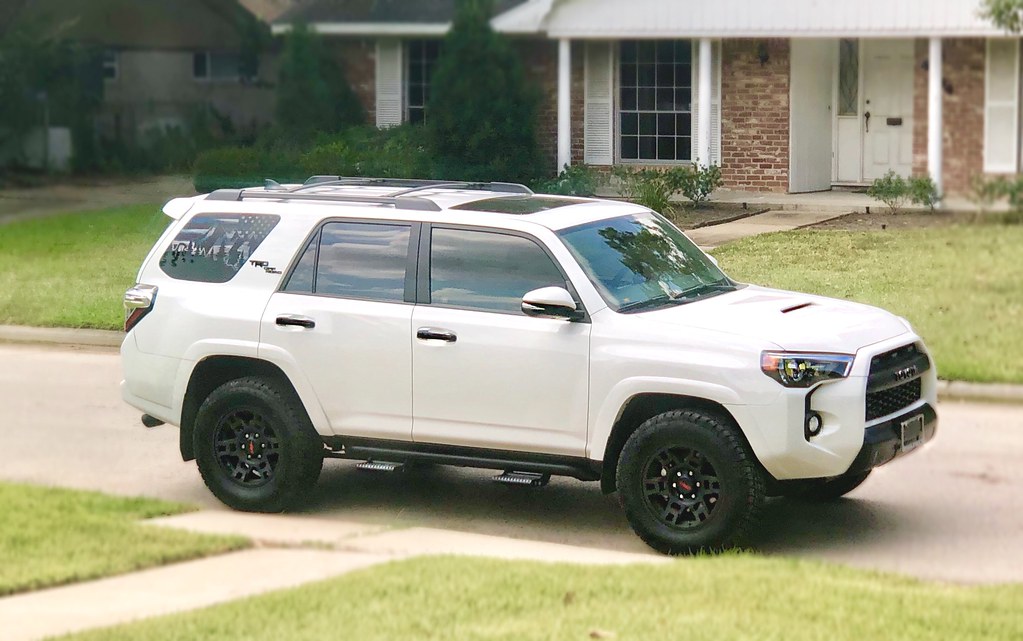

Hey ya'll. So when i got my TRD offroad, it came with these side steps. I can't call them rock sliders, since they don't...slide, because of the step. Regardless, my truck's bumpers are stock which means there aren't any points to use the Hi-jack. So if anyone knows about these steps, are they strong enough to use as a jack point if the jack was placed right under the bar and not the step itself. I apologize for the possibly dumb question, thank you!
You need a solidly attached slider to the frame. What you have is a flimsy-ly attached nerf bar to the body.
I think Jeeps carry HiLifts 1/for the look and 2/some, because with two solid axles and very big tires things get ridiculous fast.
On the 4R, we should be able to get away with a quality bottle jack. Bottle jacks are extremely versatile and though heavy they are quite compact. I also have an air jack which I no longer carry except in deep sand or the like.
There are many reasons you may need to use a bottle jack and in sand also an air jack and/or boards. But HiLift need, such as high centering, should be foreseeable and thus avoidable in normal (not play) use, even on reasonably difficult terrain.
If you can use a HiLift on all four sides and tackle very difficult terrain then, yes, I can see the HiLift having its place.
Thanks y’all, I thought about the wheel mount but one little slip in the wheel and it could go wrong. Thanks for the advice about the bottle jack!
