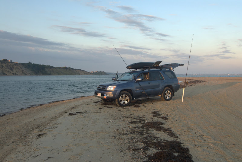

You don't need a trail edition for the beach. I take my '03 4wd Limited on the beach every year. I air down to 15 psi and lock the center diff.
A trail edition is certainly more capable offroad, but you don't need that for the beach. Driving on the beach just isn't very demanding.
