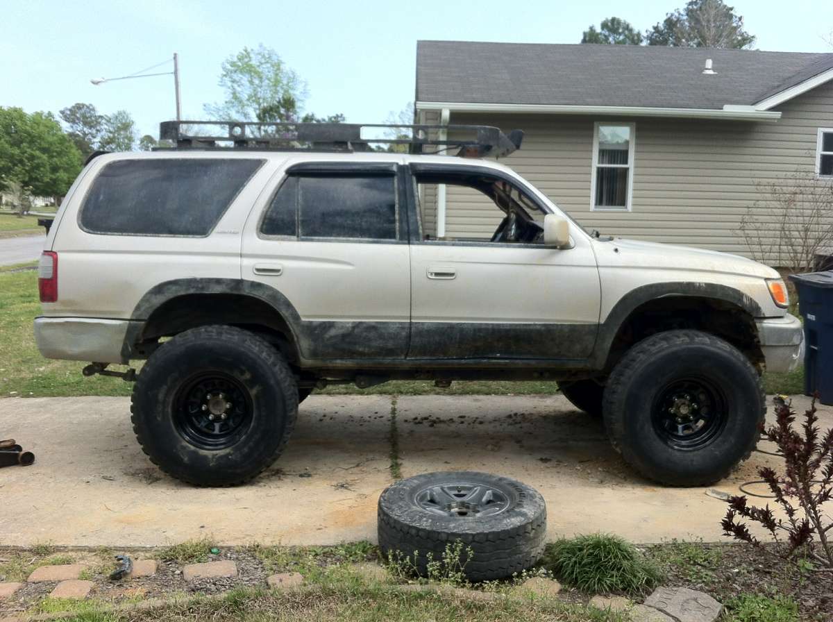

I'm running 4.88s in mine, with ARB air lockers. When I have my 37s on, my speedo is 1mph off. When I have my 265's on, my speedo is 16% off. I have the Dakota Digital speed corrector, I just haven't installed it yet. Haven't had 5 minutes to be under the truck doing it.
I don't search for gears, and still get 300+ miles per tank. I get on the interstate, set the cruise at 80, and am turning about 3kRPM. I'm glad I went with the 4.88s instead of the 5.29s, but that's my personal prefrence.

I think she looks sexy with the 37s on her. They look like the truck should've came with them. LOL.
(Completely ****ing with you. No harm intended.)
