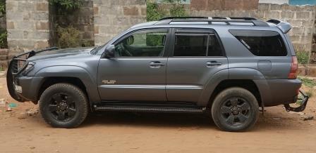

so i installed the rancho quick lifts for the fronts of my truck about 18months ago. its said they give upto 1.75'' lift, so it balanced out the factory rake, but made my nose/front end a lil too high, so i purchased the daystar 1.5'' rear lifts to balance the rear., but looking at the truck now, it appears the front end has settled, and the truck is even now...thus am confused if i should go ahead with the rear lifts installation. what do you guys think, from the picture, should i install or not?
i have billies 5100 at the rear, installed about 2years ago.

Ass looks to be 1" higher now. If you put that spacer in you will be Wayyyyyy ass high! You'd need higher lift on front to even it out.

That 1.5" spacer is what usually sells with the QuickLift and will give you the stock'ish front rake.
If you tow or haul anything the wheeler's T12 rear coils are nice +12% spring rate/+2"(1 3/4"actual) height. I have the Sway-A-Way, same thing I guess just red color. I usually have gear at 100lbs+ in the back of mine so its nice.
The T12 (SW) plus the coil isolator made mine too tall.
I ended up cutting a piece of 1/4" UHMW plastic into a round/disc shape and it sits on top of the coil. No isolator/bump stop. Could use any size you want.
I pulled the 1/4" spacers out and looked at them after 20k miles and they look good.
