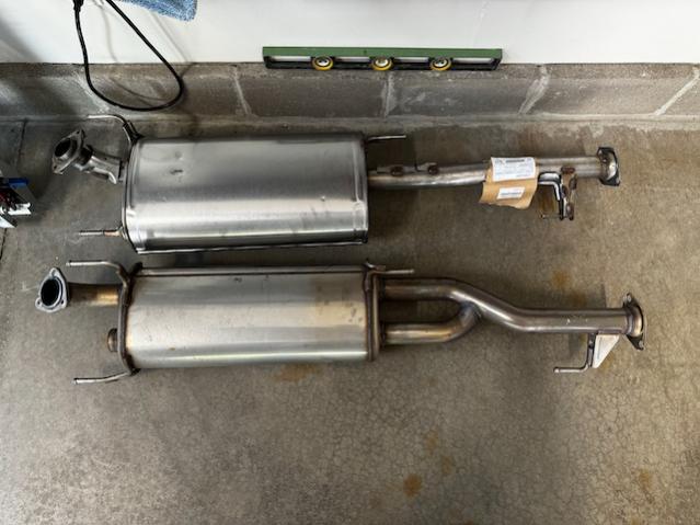

This was my solution... The drone was just too much for me. Took off the TRD Pro exhaust and put on the OEM.
You will also need the tail pipe to muffler gasket since the TRD Pro exhaust does not use it. Optionally, I also got the gasket donut gasket for the front part of the muffler. The spring bolts connecting the muffler are re-used.
Non TRD Pro Exhaust #: 17420-31360
Non TRD tail pipe #: 17430-31870
Gasket for the front of the muffler: 90917-A6001 (you might be able to use existing)
Gasket for tail pipe to muffler: 17451-31020 (you need this since the TRD Pro exhaust does not have this)
Unfortunately, I do not have the part #s for the two bolts for the tail pipe assembly to the muffler. The TRD Pro exhaust uses 3 bolts compared to the non TRD Pro tail pipe.
Currently I have it listed on Craigslist for 250 bucks...
