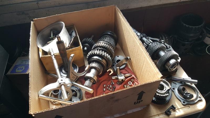

I don't remember the one I handled with play like that, granted it only had 120K on it. I had it rebuilt cause I didn't exactly trust the claimed mileage, but it was tight and mint when pulled apart. I have another in my parts rig I've yet to pull out. Here's my rebuild apart in a box. So probably a bad roller bearing on yours.
