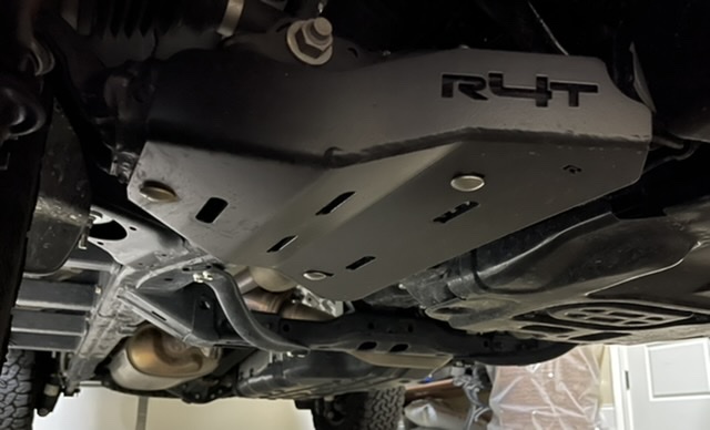

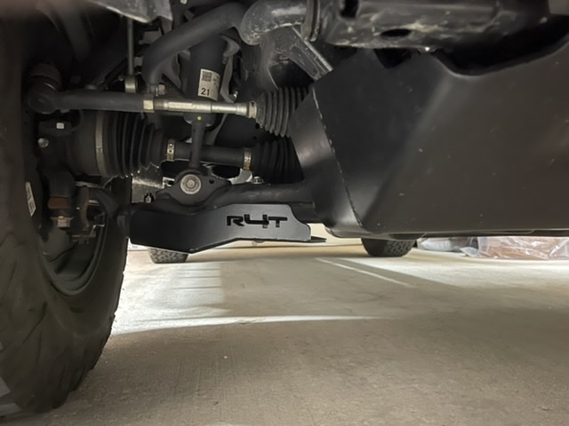

I ordered a set of Running for Tacos Lower Control Arm Skids for the T4R.
R4T Lower Control Arm Skids
So fit and finish of the skids it really good. 3/16" Steel. I ordered mine Black PC. Supplied hardware was adequate.

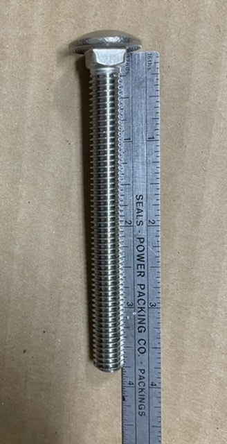

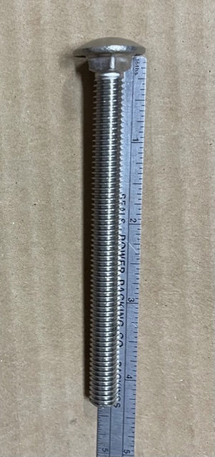

The bolts were 3 1/2" and 4" SS, I found them to be about 1/4" too short for my liking. Seems the nylon lock nut didn't have enough thread to engage. Also, I was not in favor of the small bolt near the tire end location, so hence.... Mod 1.0
To the hardware store I went, bought all new 3/8" SS carriage bolts and lock nuts.

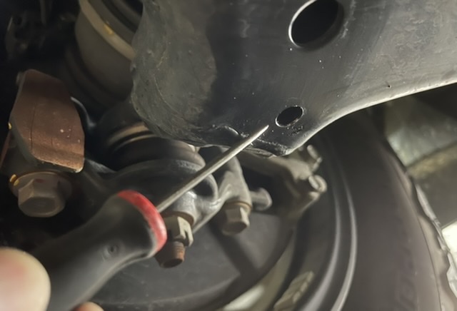

Drilled the lower control arm outer hole to 7/16" on each side.
Cut 2 new 3/8 x 4" bolts to 3 3/4" to fit in the outer skid slot.
Used the 4" Bolts in the front skid locations.
Cut 2 3/8 x 5" carriage bolts to 4 1/4".
Used never seize on all bolts to prevent any galling.
Bolted them up, fits like a glove!
See photos:

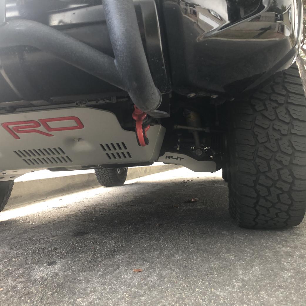

I have them in grey and they are very close to the Pro grey. Mine came packaged well and were in great condition.
