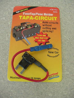

From searching the board, the problem most people have is hardwiring it into the fuse box. I found a neat little gadget at Pepboys which should help everyone out. It plugs into a fuse in the fuse box effectively splitting it. Your original circuit is fused with the 'A' socket and the second new circuit (with a 12V power wire coming out of it) is fused to the 'B' socket. I plugged into the ACC fuse, got my power and was done. Very easy.
Here is a picture like the one I found. It was $8.
