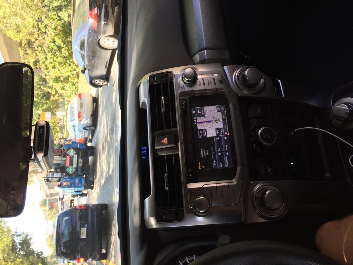

Being that my truck is a lease I couldn't risk breaking anything. That being said, I took it down to one of the top guys in Miami and they charged me like $40, they wired it using a escort smart wire that I bought them. Not even really sure how it gets to the fuse box but if you look next to the usb/aux plug in you can see the mute button glowing green in the little cubby.
That is a clean install. Is the mute just laying in the cubby or is it mounted?
