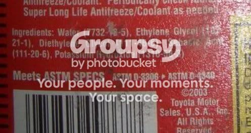

Pink is NOT pre-diluted Red. Red is a Long-life IAT (Inorganic Acid Technology). Pink is a HOAT (Hybrid Organic Acid Technoloogy). Both use phosphates for anti-corrosion which is why Toyota says it is OK to mix them. From bobistheoilguy:
Toyota red long life coolant ingredients:
Ethylene Glycol(107-21-1),Diethylene Glycol(111-46-6) Water(7732-18-5) Orangic Acid Salt(532-32-1) Hydrated Inorganic Salt(1310-58-3).
Toyota pre-diluted pink super long life ingredients:
Water (7732-18-5), Ethylene Glycol (107-21-1), Diethylene Glycol (111-46-6), Sebacic Acid (111-20-6), Potassium Hydroxide (1310-58-3)
