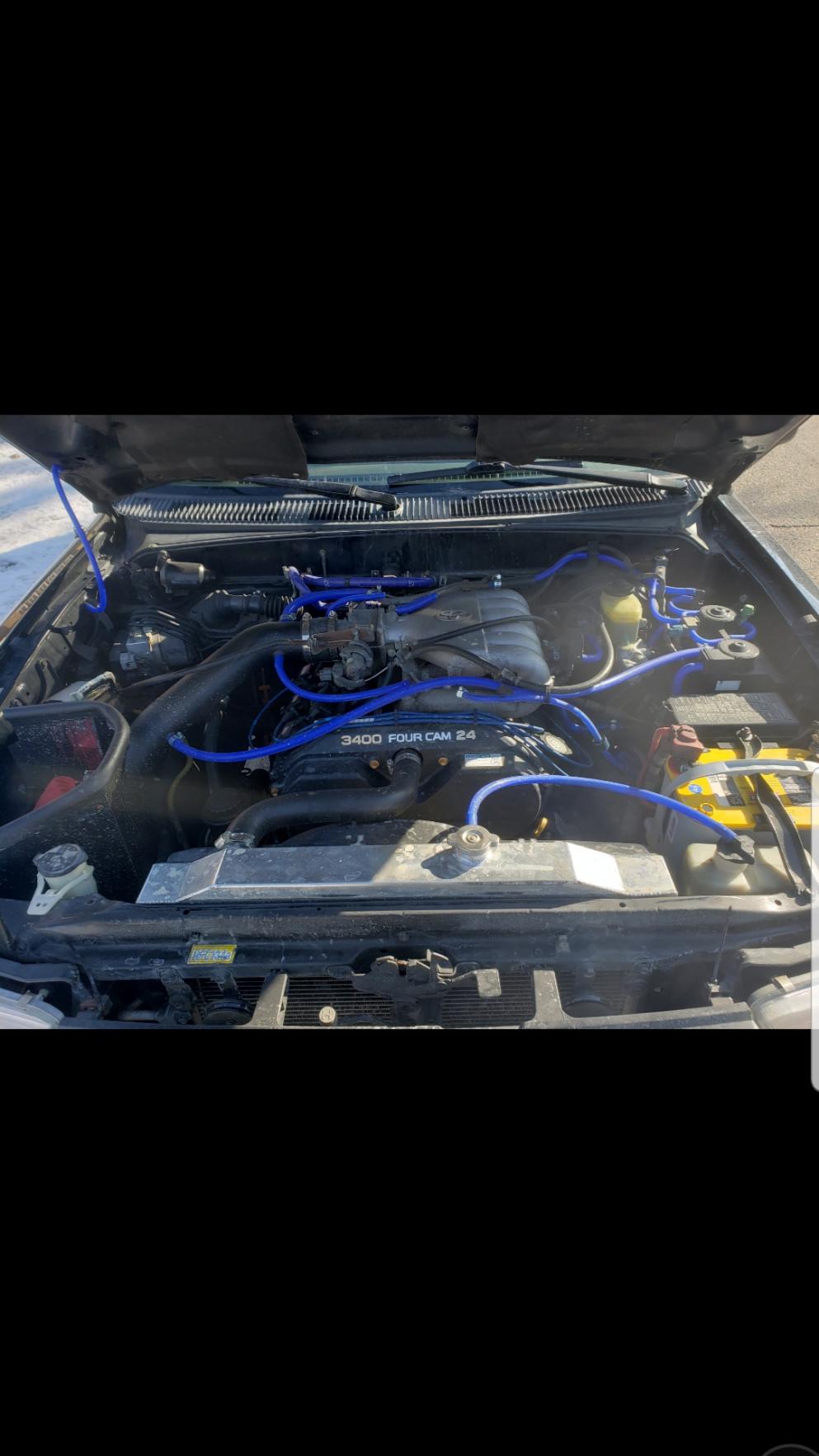

In addition to that it's a 3 row radiator instead of OEM two row. This does produce cooler engine temps. Noticeably. In the Michigan winter, my heat will blow warm when i let it idle for a while before driving it, but not anything near hot. Once driving of course my heat returns to hot but last winter I had the OEM radiator and it always blew hot even at idle. This shows me that especially in colder temps its evident the 3 row rad is producing an amplified cooling effect. I had no issues with the installation on mine either. Some complain about modifying this and that, no need. Bolt it in with factory bolts and run it. I've ran mine like that for almost a year now. No issues.

What is your engine temp when it’s blowing warm air?
Cold heater at idle and hot while driving to me is low coolant level.
