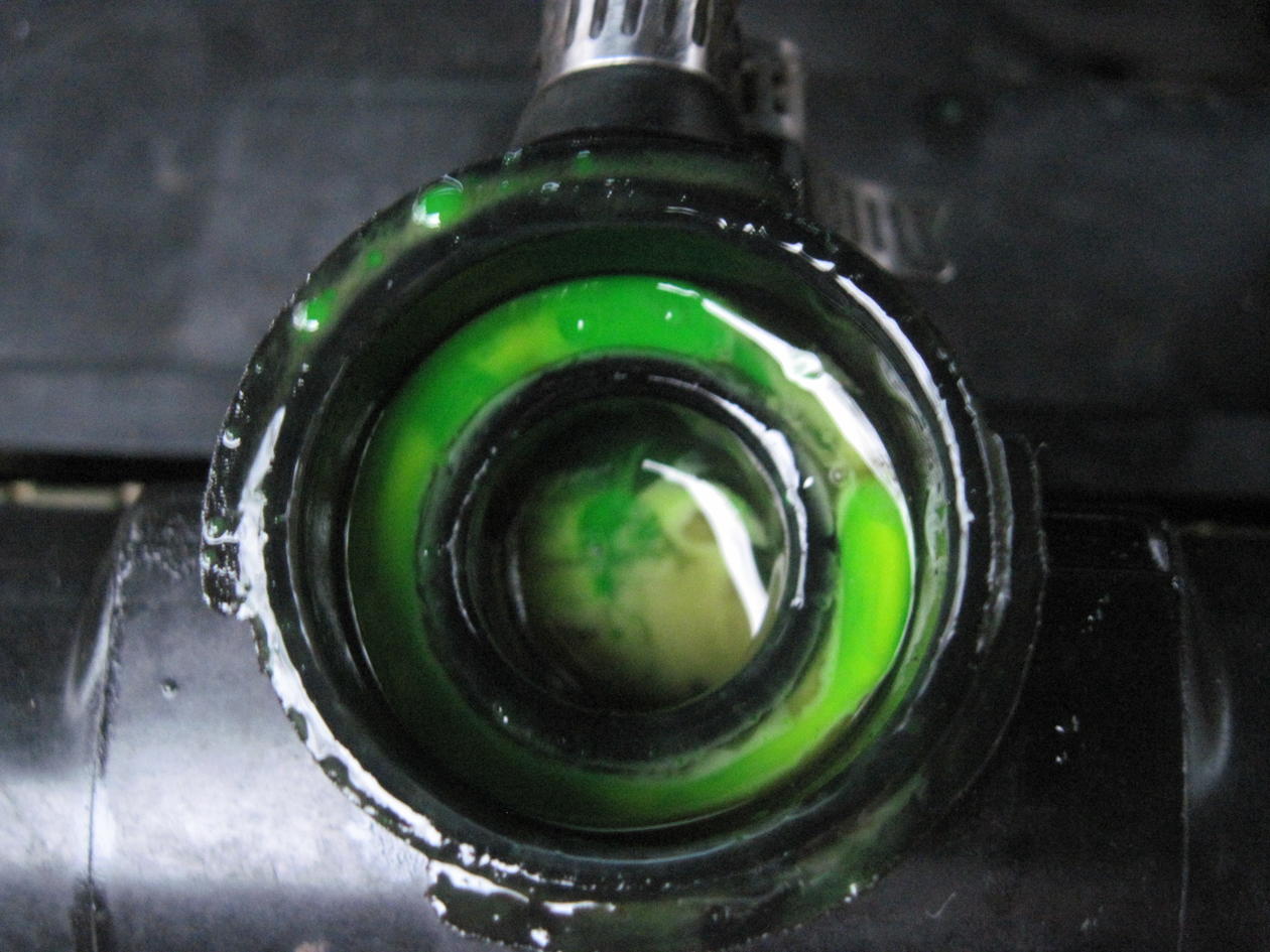

help! milky coolant
Hoping for some advise. i'm new, so please forgive me if i'm doing this wrong (posting in wrong area/thread etc.) I bought a 97 with 190k from a used car dealer two weeks ago.
Drove it on a 500 mile trip and when i returned, i checked my fluid levels. The coolant reservoir was empty so I opened up the radiator and saw a creamy goo in with the green coolant. It was not overheating or even running hot. The engine oil is clean and full. The transmission fluid is clean and full.
If the truck had red coolant in it and the used dealership topped it off with green coolant could the mix cause thick whites goo? Or is this a milkshake (trans fluid in coolant) or head gasket issue? I'm attaching a pic.
What should I test/do? Any advise would be so much appreciated. thank you!
