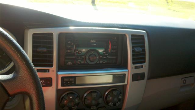

I finally got a radio installed in my 04. It really wasn't too bad. I got the Clarion cx609 due to the bluetooth and double-din look. I'm really glad I went with the couble-din since it looks pretty stock The LED's change to 768 different colors, so I have it color matched for now as well.
I have the usb cable snaked through the dash to the pocket below the climate control so I can just pull out the cable from there when I want to use a USB drive with it.
I'm really loving the bluetooth. I can talk rolling along at 40 with the windows down and it's clear on the other end. Another cool thing is that (at least with my DroidX) I can stream music from the phone over bluetooth... no more using the aux cable or usb connection (although it has both).

Wow! That looks really good. Im just curious how much that cost you? I might want one myself. The bluetooth music streaming sounds like a good idea because then there's no need for messy cables in my truck anymore.
it was about 315 shipped from crutchfield with the install kit included and all that...
I love the fact that it just automatically connects when it sees the phone (when you're in the car and it's on) You have to do nothing... love it!
The sound is excellent actually, The one problem I found is the signal strength on the tuner isn't as good as stock (not bad, just not quite as good at locking in stations), but especially when plugged into bluetooth or aux devices it sounds awesome.

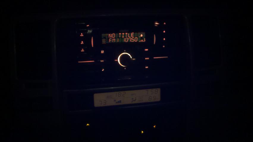

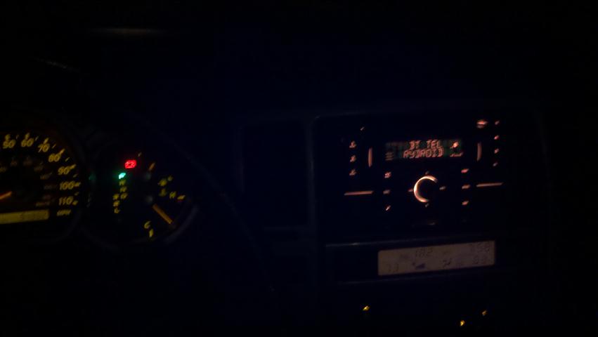

Just got some, I was waiting for night time. I may be able to match it a little better if I tweak it some (it's fully adjustable RGB):
That looks great. I bet it is much more enjoyable than the factory deck. I will have to check out Crutchfield - as I cannot seem to find a Scion T1809 anywhere.
