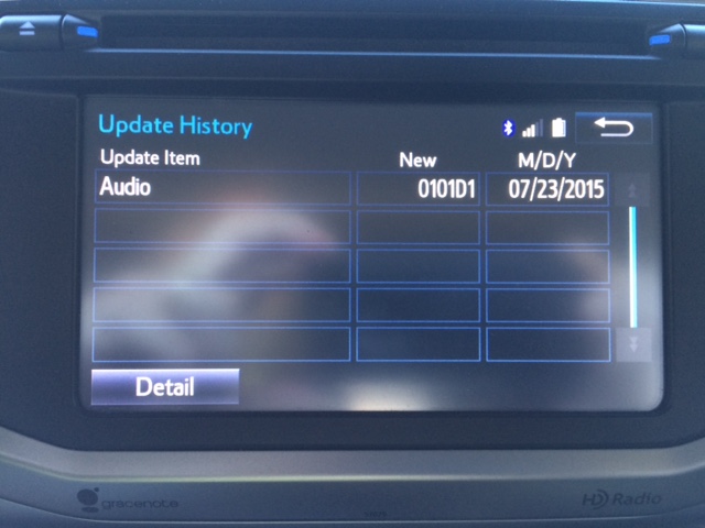

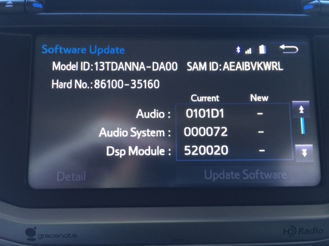

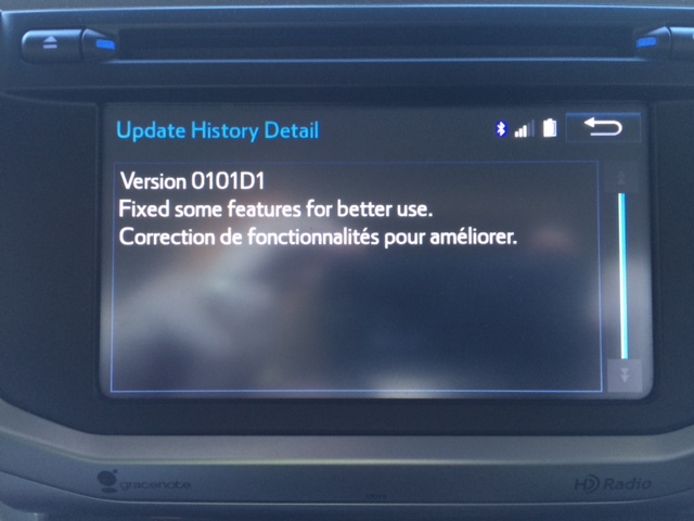

Update:
The dealership installed a new update today, see photos.
EDIT: Update to software had to be done via Techstream, otherwise I had the latest update.
[MENTION=103267]Saker[/MENTION]
When you did the update, did it erase any settings on your unit?
[MENTION=53960]itsdchz[/MENTION],
When updated I think the voice on the navigation went back to about 4.
I haven't had enough time to look at everything yet....
:sorry:
:sorry:
If you didn't notice anything else, thats a good sign. I was worried about all the radio presets, sound settings, nav settings and address book etc.
Sounds like a minimal inconvenience for the update. I'll visit my service dept this weekend.
Thanks!
Thanks!
None of that changed. Very un-intrusive update.
I just hope it fixed the issues.....
