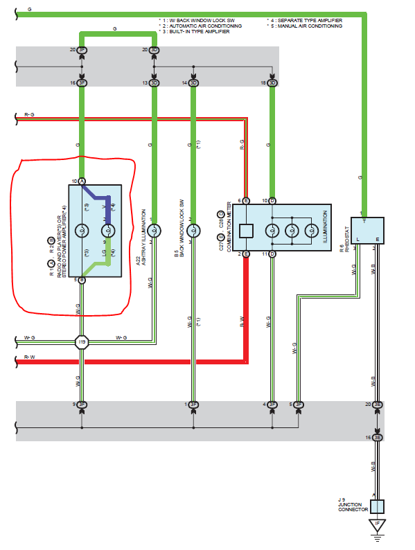

Does anyone know definitively which of those wires controls the radio illumination?

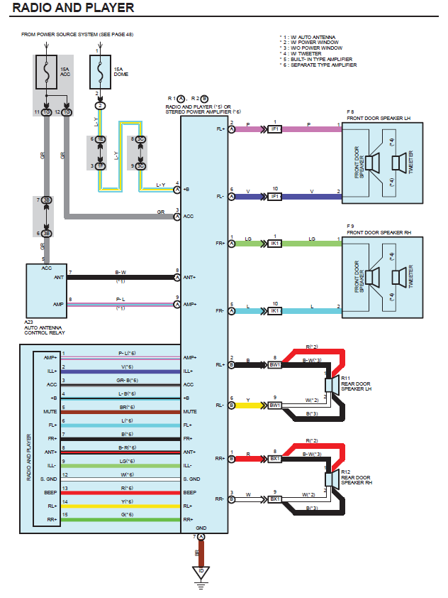

Thanks for your input...but seriously, I disagree. My unit works fine...I am not interested in replacing it. I am looking for information that some here may have the expertise to provide. I am quite capable of making the needed repairs if I have the proper information on the wires in the harness...I figure someone here may have done that work. I am a tinkerer and I like to fix things not just replace something that for all intents works fine.
I'd love it if someone has properly mapped the harness wires and can provide that information!

I had the same problem (radio worked well, but no lights came on) with my T4R when I bought it about 2 years ago. I ended up replacing mine, but determined the wiring harness in the back of the radio (from the amplifier) wasn't making a clean connection. When I jiggled the connector, the lights would flicker on/off.
Hoping the attached pictures (wiring diagrams from 2002 T4R) come through and help out. If not, let me know if there's something else I can do to help.
