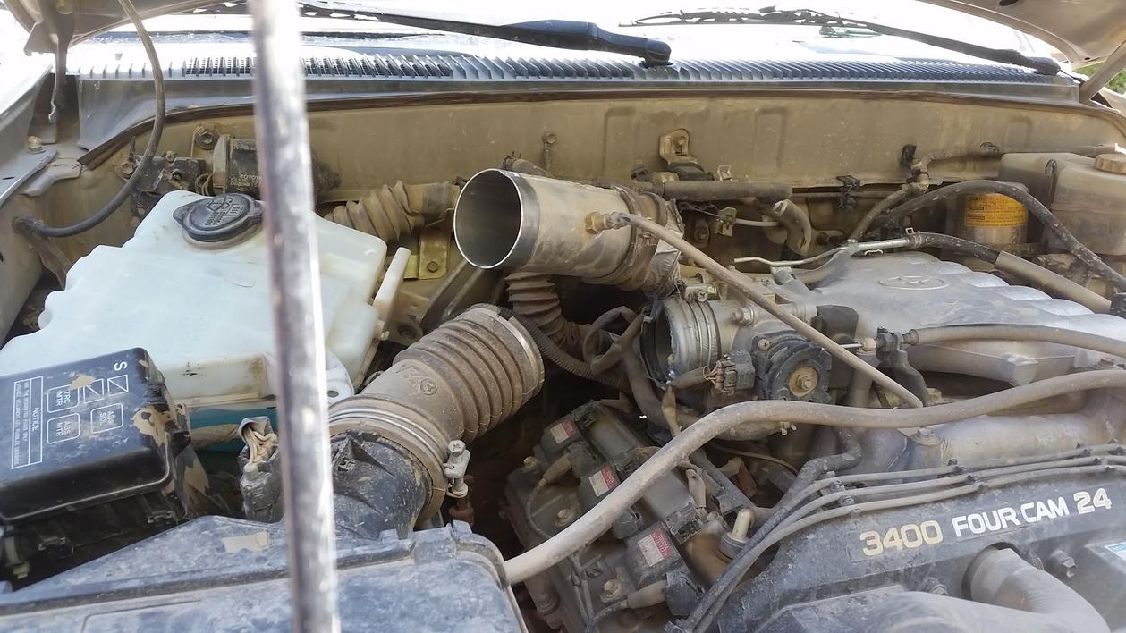

anyways got it home barely, there is a bracket for a gas line that is being stubborn and sometimes contacts the steering extension. also my intake decided to desintegrate after the body lift, body and air box move up engine stays... also discovered that some mechanic my dad used to use had taped the intake together and attempted to glue the cracking rubber... wtf man.

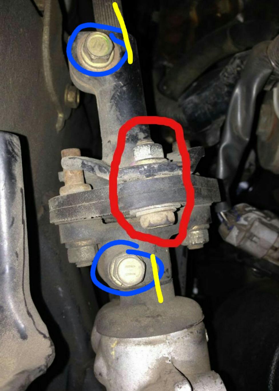

mark the yellow lines, undo the blue bolts and remove the entire thing. then you can put it in a vice or do whatever you need to do to make it chooch.

So I've done what you suggested, and can't get the damn thing to budge to remove the entire thing. Any tips?
You might be able to jamb a screwdriver or like tool in the slot on the side of the upper bolt to spread the joint out a little.
Spray some oil in there to help.
The whole shaft assembly collapses some, maybe pry up on it to collapse it and see if you can get it free?
Did you already try soaking the bolts with penetrating oil for a good while & longer if there's any rust?
I sometimes forget how effective penetrating oil is on stuck bolts...even ones that aren't rusted. Was just reminded of this when I was replacing my engine mounts.
