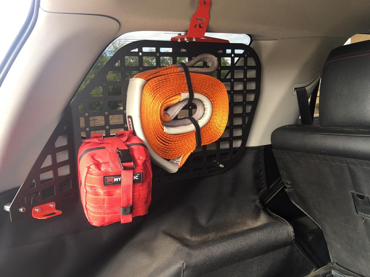

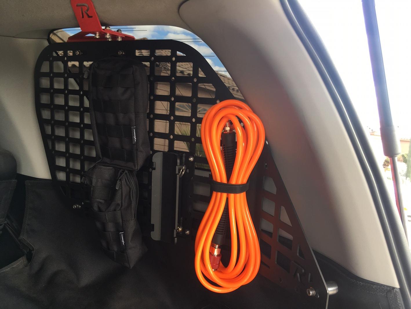

I spray painted mine since they are going to be on the inside.
