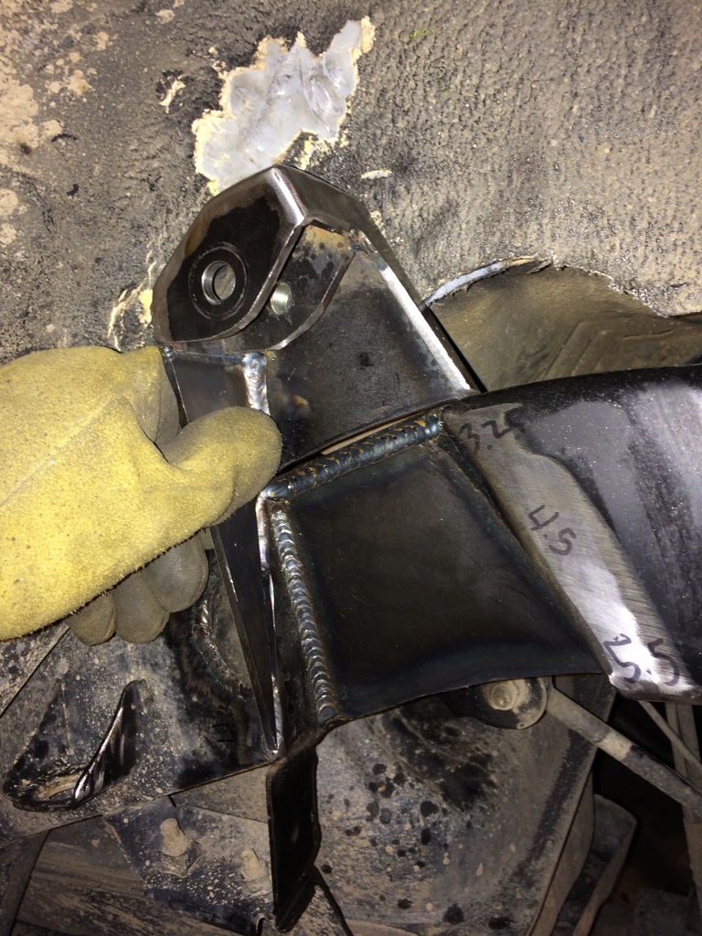

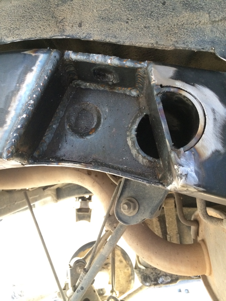

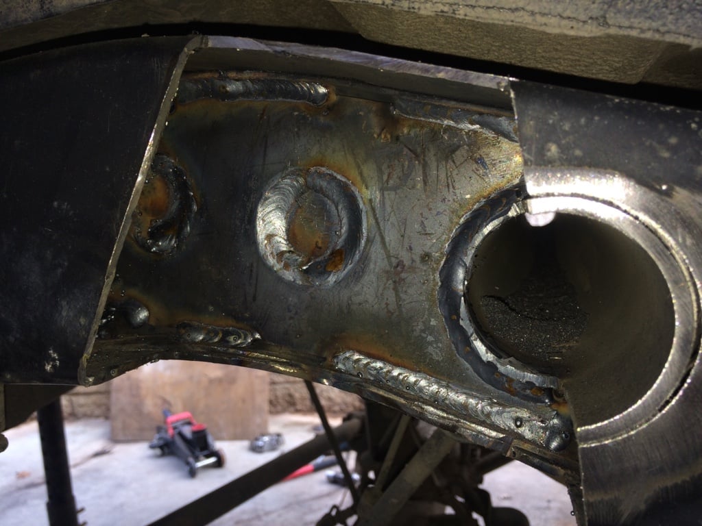

Almost done with the upper mounts. The frame is plated along the inside and boxed in the area that has been notched with 3/16 plate. Waiting for some paint to dry so I can weld them up to the frame and add some frame plates on the outside of the frame. Then I can start at the lower mounts first thing in the morning
Nice welds, are you creating a weak point in the frame there? I see the plates for added strength but it looks like an area that can crack in the future. No engineer here.
Yeah I’m no engineer either, but I think it’ll hold up fine. So far no issues.
