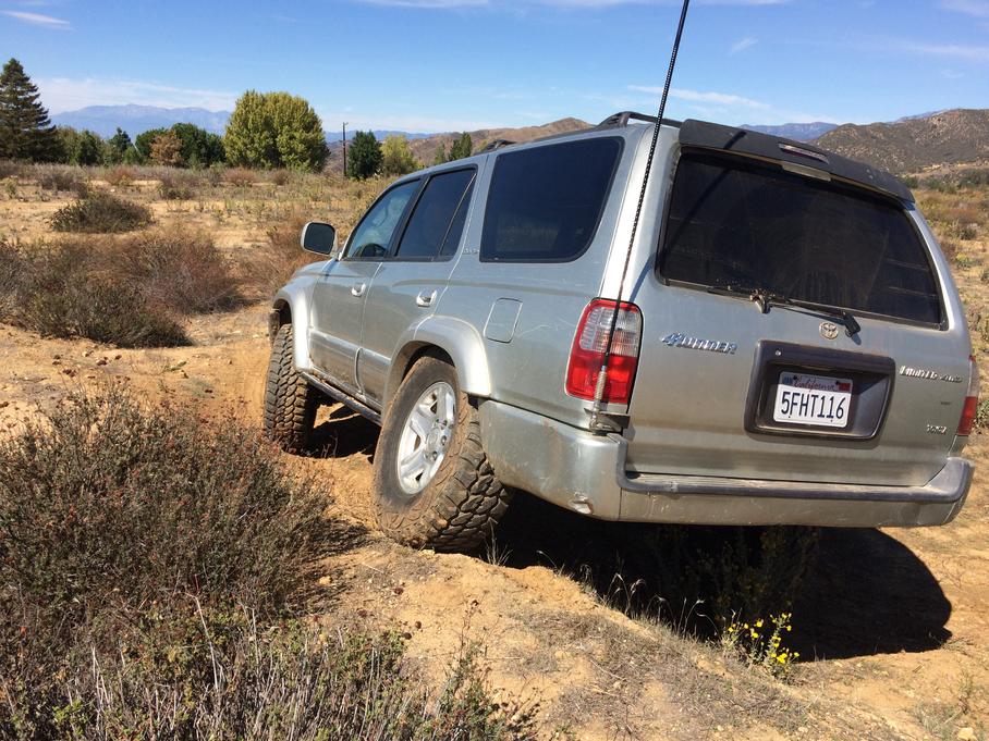

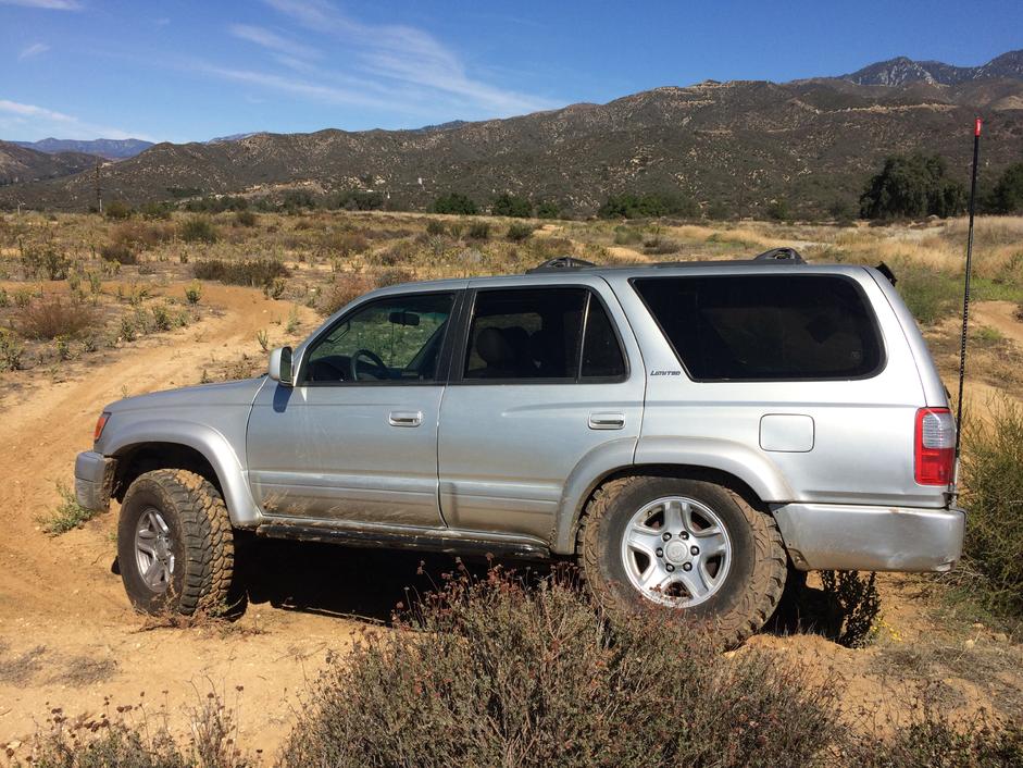

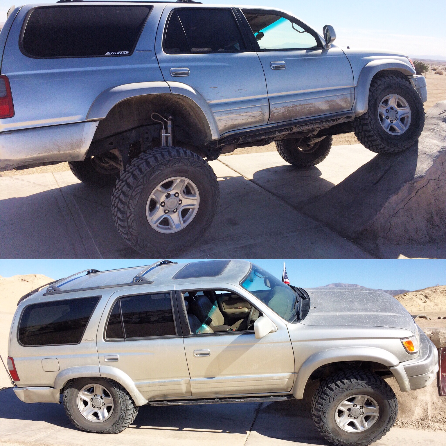

I am overthinking it and I could do all the stuff you are saying but it would make for a fun weekend project and I've always liked the outboard rear shocks. I pulled my rear sway bar off this morning and trimmed the cone bump stops a little bit and it stuffs perfectly up in my wheel well now at bump stops. I wouldn't really want it going any further up in there now. I definitely don't want to extend the bumps though. Fitting some shocks between the tire and frame is going to be a real tight fit but definitely possible.

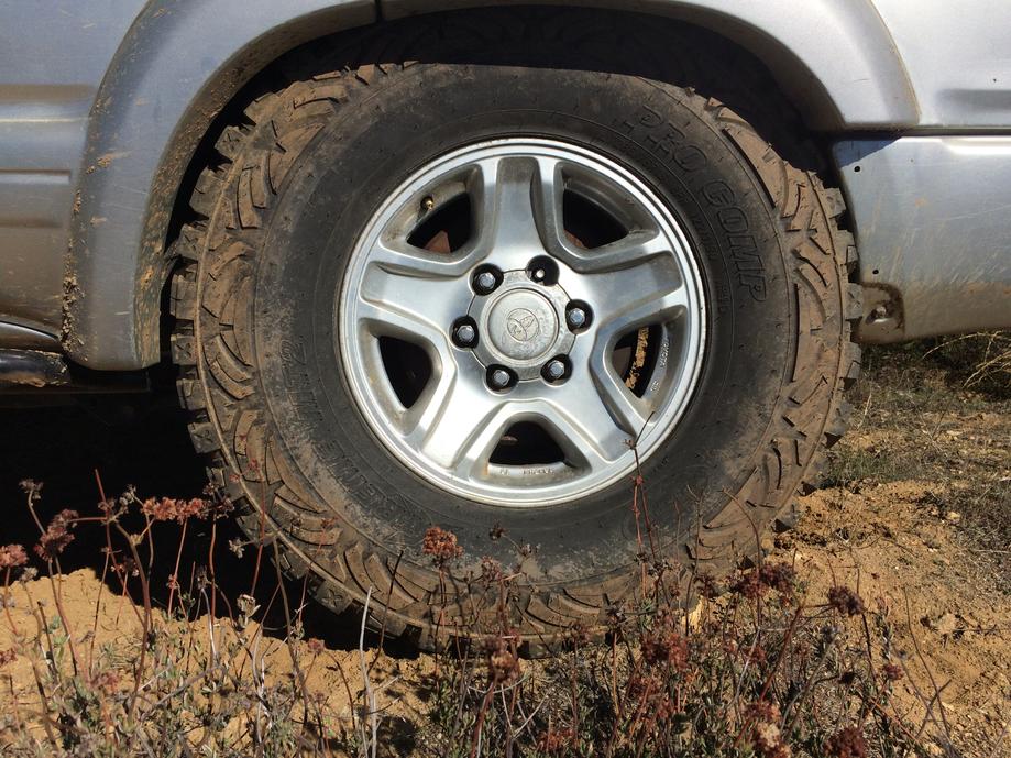

You can see how stuffed the tire gets in the wheel well with the cone bumps trimmed. I wasn't ever hitting the regular bump stops before but now I can do it with ease. I cant wait to get my shocks now.
and yes I am missing a lug nut on each wheel. They had wheel locks from the last owner and he had lost the key. I haven't put new lugs on yet haha

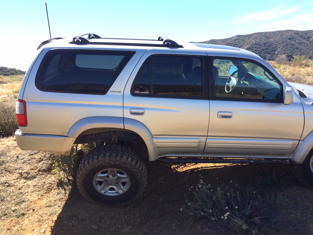

Here you go. It's not fully drooped but the other side was fully stuffed up to bump stops. It was pretty damn close to being fully drooped though.

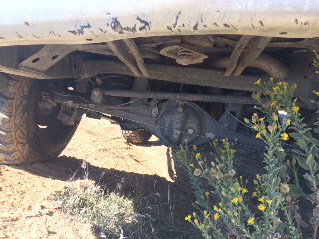

From the back. Not a good shot since there was a bush and I was short on time to get good pics

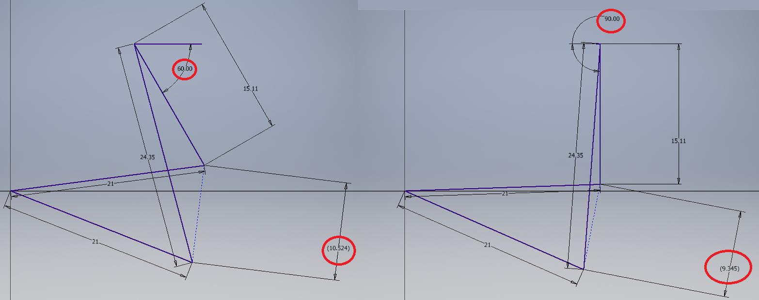

keep in mind that if you angle the shock away from the axis of travel, you can actually have more travel than if it is inline with the axis of travel, but the rate of damping will decrease going from fully extended to fully compressed.
ive made a constrained model here using the 9.345 travel shock and a 21 inch control arm, then I have simply changed the angle at which the shock is mounted by having it move forward on a horizontal line which is like the frame rail. even in ripcords picture his shock is angled away from the axis of travel.

Thanks! I plan on having about a 15° forward angle on the shocks. It will help increase travel slightly and clearance since it won't be where the wheel is furthest towards the cab at full flex. And since the shock angle will only be slightly angled the dampening should only be reduced around 5-10%
you will actually have less angle than stock, because the stock shocks are angled in about 30 degrees or so.
Yeah that's the plan. I don't want too much dampening to be lost by going more than 30°. That's one of the points of going outboard with the shocks. I may end up going closer to around 20° angle but I don't think I will need to go as far as 30°. Since I'm going to be running a 12" travel shock I would run into other issues like spitting a coil or binding the stock 4 link if I tried to go for more travel with a 30° angle. I am going to try to find a sweet spot with the angle to find out the most I can go without having to run limit straps. Im already hitting my gas tank skid at full flex right now but I plan on hammering that in as far as possible to avoid that issue. Tomorrow I am going to mock everything up to see how far I can go and start making the mounts. Hopefully I will be finished Saturday sometime

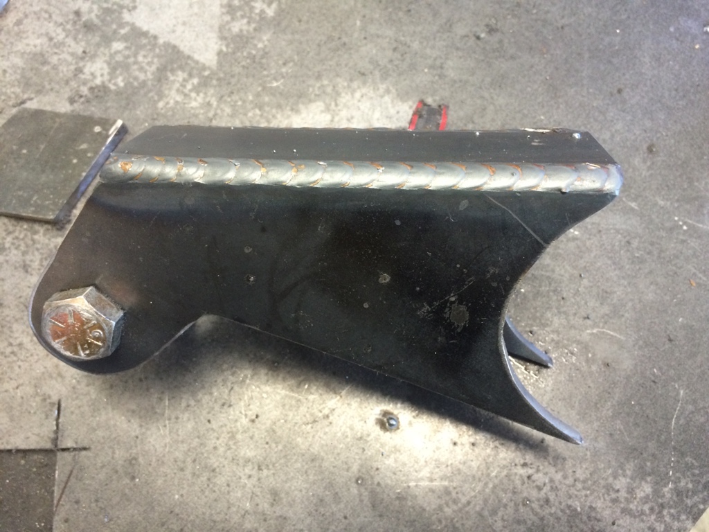

Well here is we're I've gotten to today. I've made the panhard drop bracket and almost finished the first upper mount.
Almost done with the upper mounts. The frame is plated along the inside and boxed in the area that has been notched with 3/16 plate. Waiting for some paint to dry so I can weld them up to the frame and add some frame plates on the outside of the frame. Then I can start at the lower mounts first thing in the morning

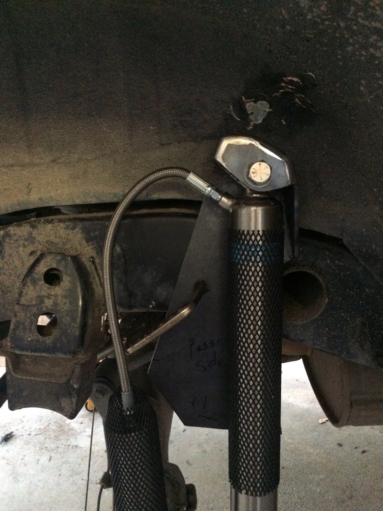

Also an update on the progress. Upper mounts are done. Lower mounts are welded up but not to the axle yet.
I really like the whole setup. It was a lot of work but in the long run I have better shocks and more travel than I would have with a regular lift. I don't think I would be able to do much differently. Thinking back on the whole thing, I may have been able to get longer shocks and just run limit straps and extended bump stops but the whole reason was to keep stock up travel.
