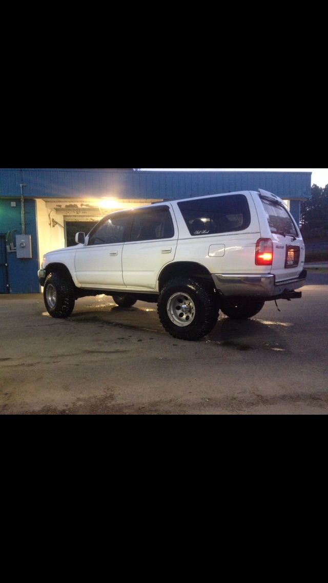

Like the title states I have 5100's on the highest setting and stock springs up front and the OME 890's out back. The front still seems to sit considerably lower than the back. Would a stiffer spring in the front bring it up a tad more? What level would I set the Bilsteins on in cooperation with a front lift spring? I'm going to be adding a tube bumper shortly as well so I feel like the rake will become even more exaggerated at that time.

That confirms my suspicions of what I need for the front. Thanks guys. Here's a pic I found on my phone. It isn't much of a rake but it bothers me.

Your rake is fine. I see nothing wrong. IMO I like the look. If you still have stock rear cone bump stops installed, removing them will drop rear 1/2-3/4" ride height.
