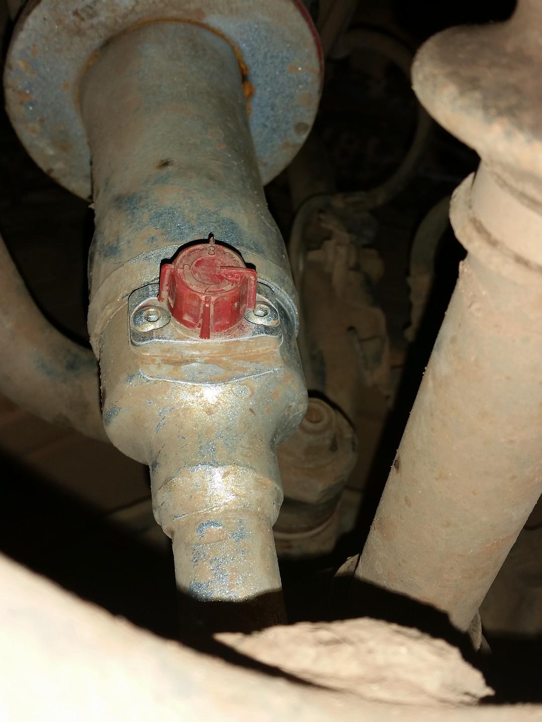

resurrecting an old thread..
am a lil confused how to adjust this unit....i see numbers 1,3,5,7,9
I tried adjusting the knob from end to end, but I didn't see any difference/change in hieght.
attached is a pic...hoping some1 can point me in the right direction
just so you know the adjustments on the shock are not lift height, they are for the stiffness of the shock. I would recommend going 7 on the front and 5 on the back as a starting point. Adjust from there to your liking.
because of the post above you
