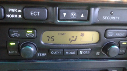

I have an A/C problem on my 1999 Limited.

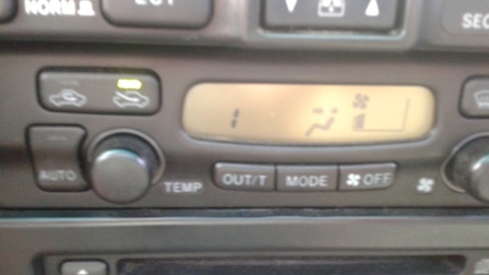

The A/C randomly works or doesn't work. The A/C blows cold when it works. Sometimes when I start my 4runner I get a single blinking digit on the front display and the A/C does not work.
To get it to work I have to shut the 4runner off, I have to put the key in the ON position without starting it, i have to turn the key one click left very quickly and then back to the ON position. I have to keep repeating this sequence until I see 75 on the display and the fan symbol. Once I see this I can start the 4runner and the A/C works properly.
Any ideas what the problem could be and how to fix it?
Thanks for any help.

Just checked the FSM and the "1" on your display (from your photo) says the "air mix damper" is "0% open". Probably means the code 31 that your air mix damper sensor is shot....

I just wanted to take a second and update this thread.
After doing some research the Digital Climate Control was faulty. Not all of the buttons were working. Turns out this is a common problem with the 4runners and tacomas that have this Digital Climate Control.
So long story short I removed the Digital Climate Control, shipped it to a company on eBay that specializes in repairing these Digital Climate Controls. They replaced all the components inside the unit and tested it to be sure it was working properly before they shipped it back to me. The total cost was $100.00
Total time for me to ship it to them and get it back was about a week. Needless to say I'm really happy now cause it works great. All the functions work properly now. And I got cold A/C :dance:

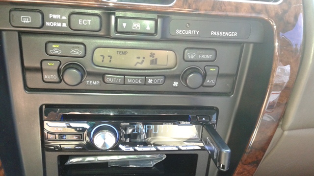

Sounds like something is wrong with the digital control. Do the buttons work properly on the control?
