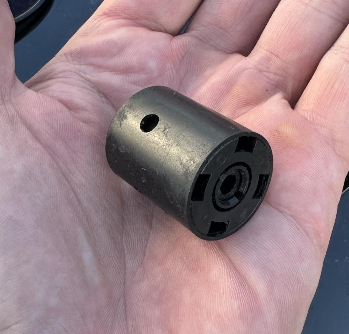

What is this part I found lying on the skid plate when I removed it? It's plastic.

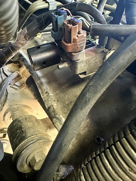

Thanks for the reply. I did find out where it goes. On drivers side below evap canister area. There's two of them. Seems like some type of muffler. Not really sure, but I put it back on and seems to stay put so far.
MikeM
Its is the air filter for the ADD vacuum switches. Keeps the VSV clean when releasing vacuum... good you were able to find it - I'm missing one...
-Charlie
Thanks for the help! It is indeed the air filter for the ADD vacuum switches. Popped that one back on no problem. Still missing one.
