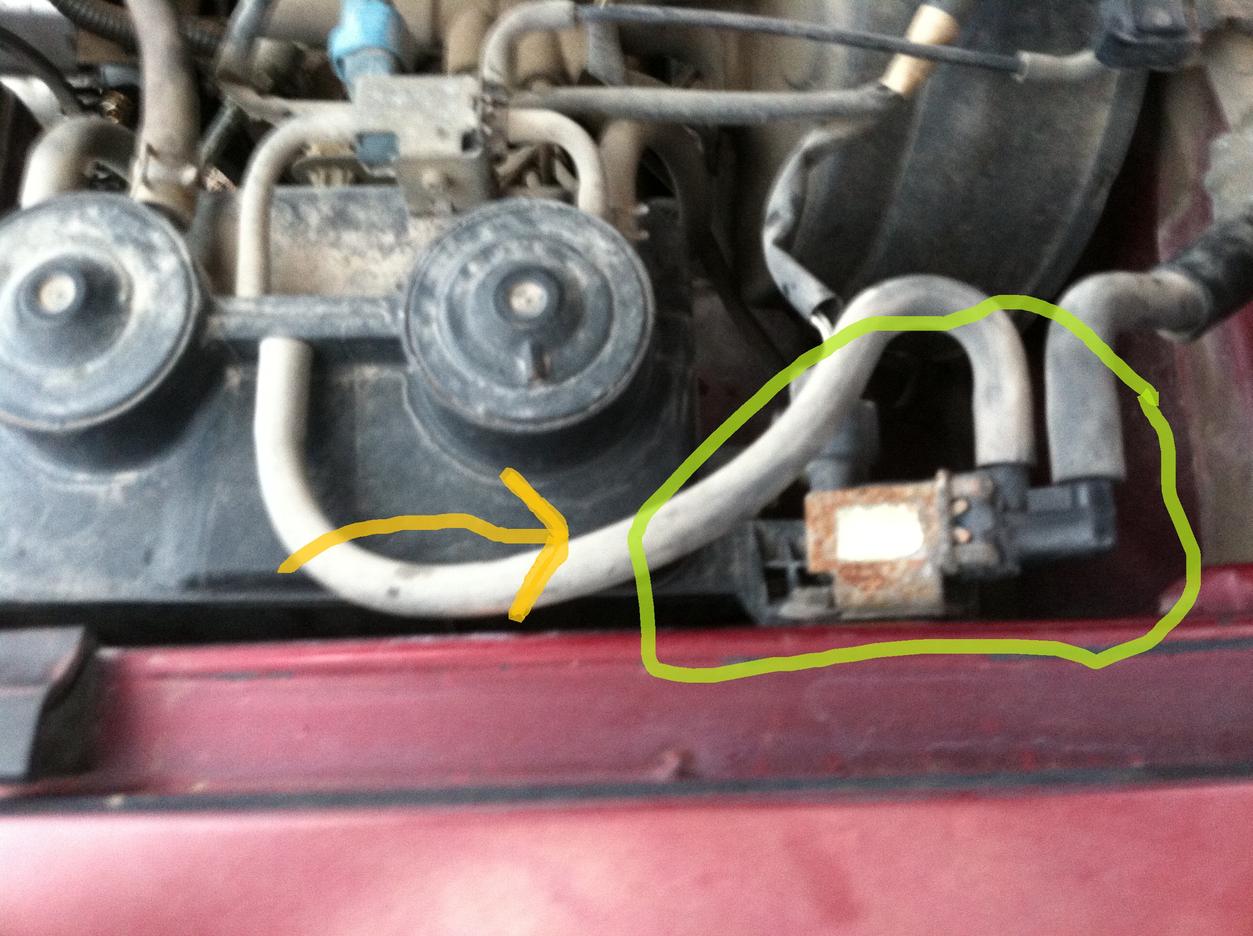

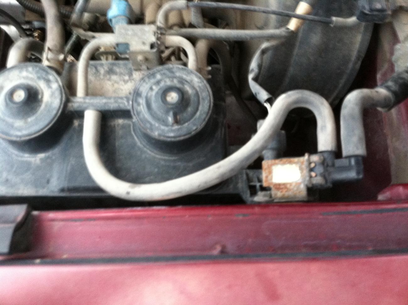

Its a 96 V6 (3.4) I went to look at it right now and yea the switch doesnt make a difference.....Also I heard a ticking noise and there was a sensor(?) making a ticking noise and I'm going to post the pick
The ticking sensor
Its the sensor on the right that runs a vaccum line to the back of throttle body

I circled it
This is the one.....:gun6:

The thing circled is the EVAP solenoid. I have one go back on a Chevy truck once but I cannot recall anyone having theirs replaced on a 4runner, even though 2002 models sometimes have to have the whole canister replaced.
