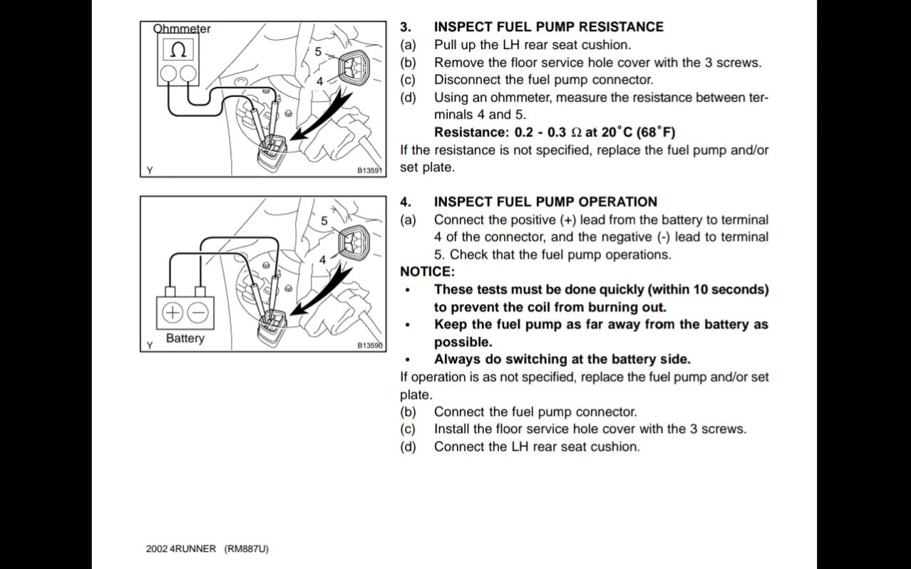

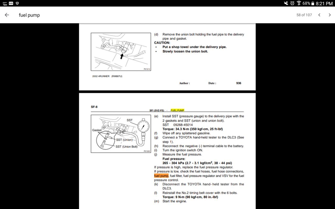

It is a little bit of a chore for sure but can still be done. Not sure but may be you can get the fuel pressure gauge kit from an auto parts store loaner program but here are some pages from the fsm Screenshot_2019-01-28-20-22-39.jpg

Real good info for sure, reading of FSM is a prerequisite to working on it.
